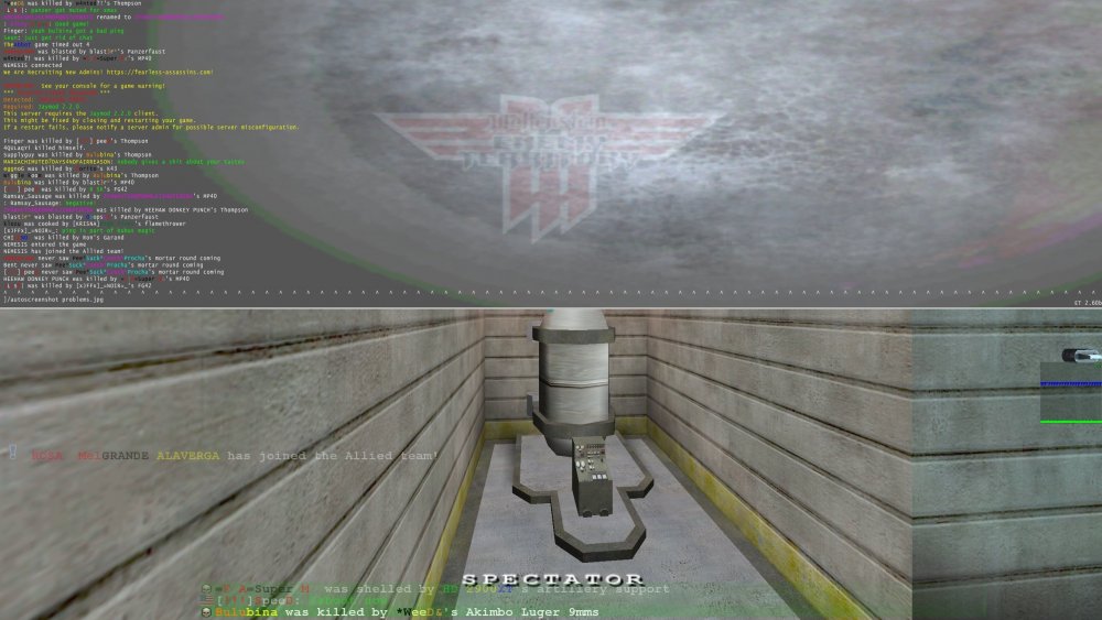

Had this error when I connected earlier, can anyone tell me what this might mean? Looks like server side?
