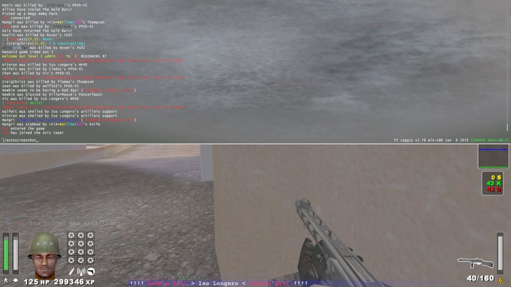

DeKing Posted August 15, 2021 Share Posted August 15, 2021 On 8/14/2021 at 9:50 AM, Leatherface said: i only gotta ss of 1.. And i know buckwild got some more, maybe details to The Game timed out 3 ? I also see this on B2 1 Quote Link to comment Share on other sites More sharing options...

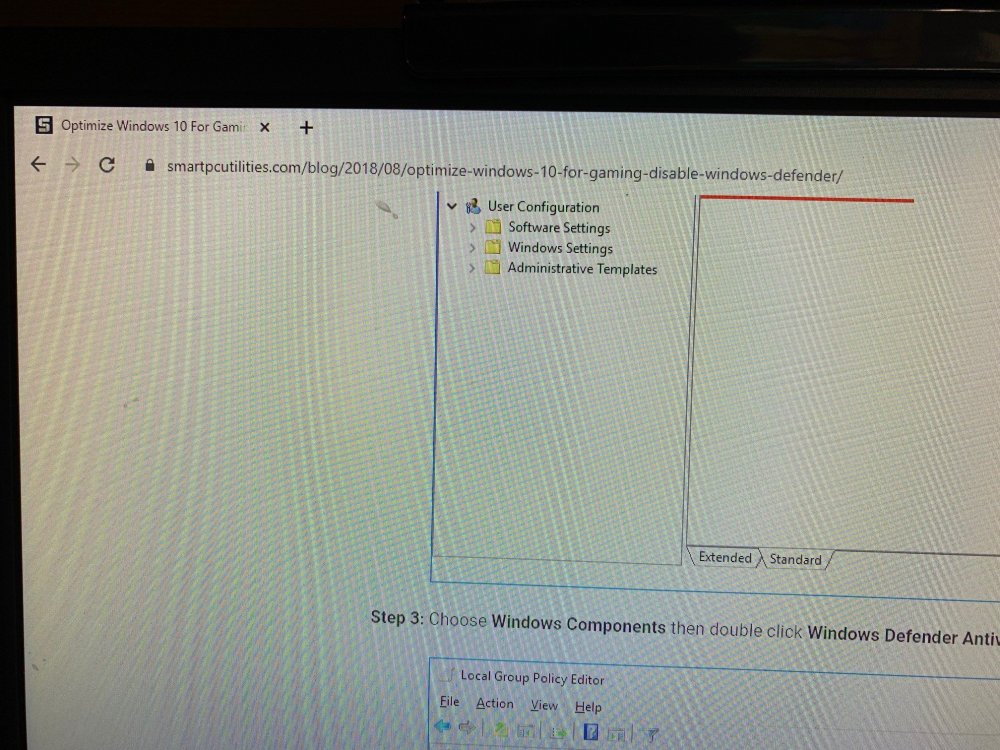

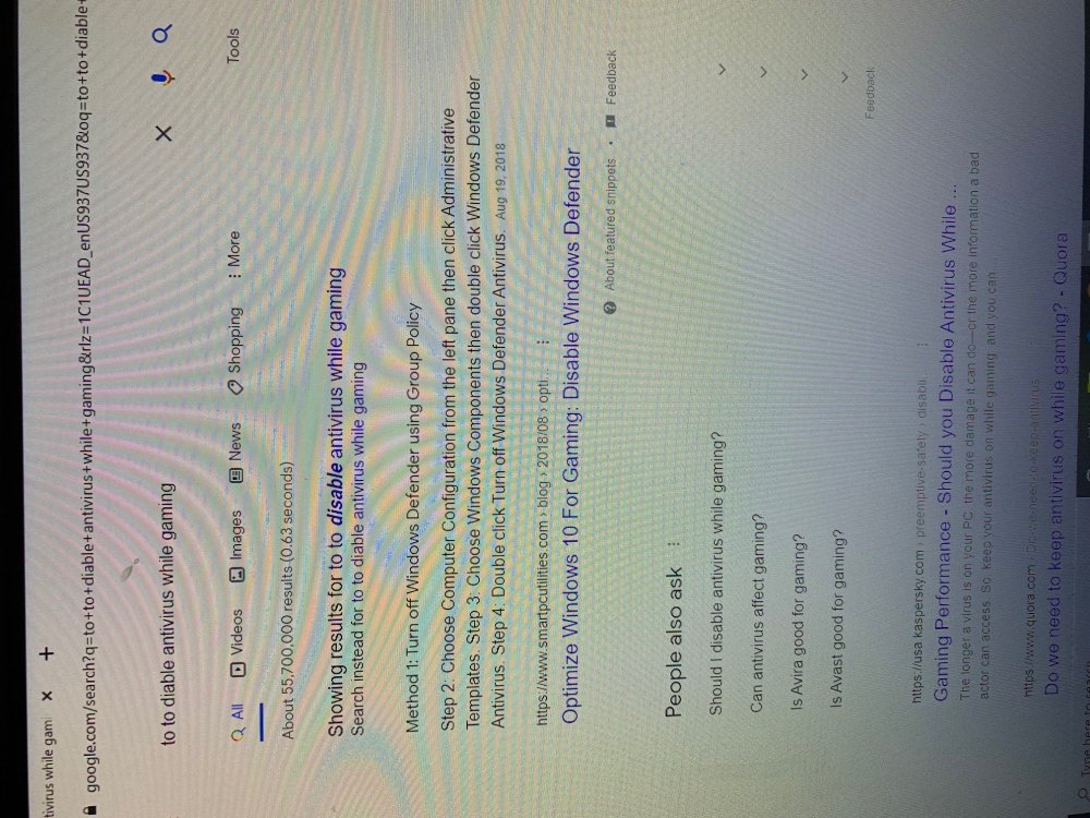

Platinum VIP nAbish Posted August 15, 2021 Author Platinum VIP Share Posted August 15, 2021 Did this here to disable antivirus, so far it's working. 1 Quote Link to comment Share on other sites More sharing options...
Platinum VIP nAbish Posted August 15, 2021 Author Platinum VIP Share Posted August 15, 2021 UPDATE: Still working I'm sure this was the culprit the whole time. Game running great. 1 1 Quote Link to comment Share on other sites More sharing options...

Platinum VIP nAbish Posted August 20, 2021 Author Platinum VIP Share Posted August 20, 2021 So I've disabled my antivirus and firewall. Every time I start ET, I go into task manager and set priority to HIGH. Right click ET and set AFFINITY to use only 1 pc (core). Working so far, @HipKat can you test this on yours and see if it helps? I want to get this figured out. I've got loads off ss of people with "game timed out 1-4" They have to be having the same problem. There IS a solution. EDIT: fyi I leave task manager open while gaming, when closed seems settings are not saved as you cannot "apply" these changes. When stopped I believe it goes back to normal. 3 Quote Link to comment Share on other sites More sharing options...
