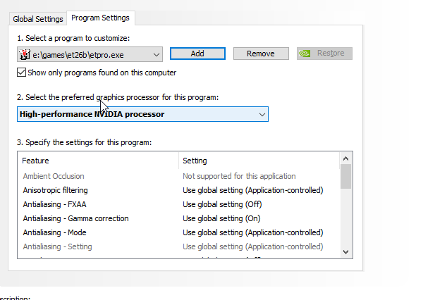

Dougo Posted February 21, 2020 Share Posted February 21, 2020 -Threaded optimization : Enable -Vertical synchronization : Enable make sure these are off 100% of the time. use R_finish 1 to sync frames, VSYNC causes massive imput lag Image Sharpening : Use the global parameter (off) -Anti-aliasing, FXAA : Use the global parameter (disable) -Anti-aliasing, correction gamma : Use the global parameter (enable) -Anti-aliasing, mode : Use the global parameter (Improve the application setting) -Anti-aliasing, setting : Use the global parameter (2x) -Anti-aliasing, transparency : Use the global parameter (disable) make sure all of these are off as well /r_primitives 2 is on, make sure you set your affinity to a single core (not 0 or 1 core) this will help as ET was designed for single Core as well as your priority to high, cl_packetdup set to 1 things like your Resolution can play a huge diff, i use 3840x2160 so i need to up the maxpackets to 125 and use Rate anywhere from 60k to 80k. SV_FPS can be a good 1 as well, try and find a good medium ranging from honestly like 15 - 125, it seems to be very different for diff ppl ( i know your supposed to use 20 or 40 but try it out the difference is quite huge if it still sucks let me know, ill keep adding more things lol 1 Quote Link to comment Share on other sites More sharing options...
