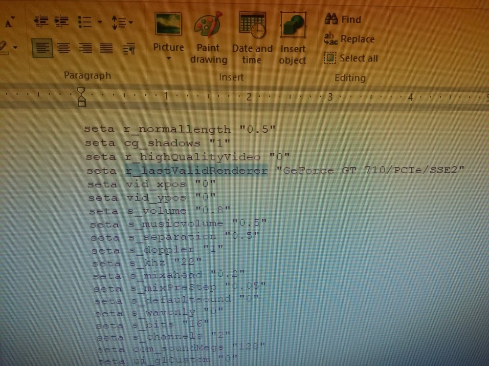

0 Leader RedBaird Posted September 21, 2019 Leader Share Posted September 21, 2019 Just for curiosity's sake, can you open the etconfig.cfg in your profile folder in etmain? See what value it has for "r_lastValidRenderer". It should be the same as your current video-card, not the one in your previous computer. If that has a 'wrong value' then it could be a clue to the mystery... 1 1 1 Quote Link to comment Share on other sites More sharing options...

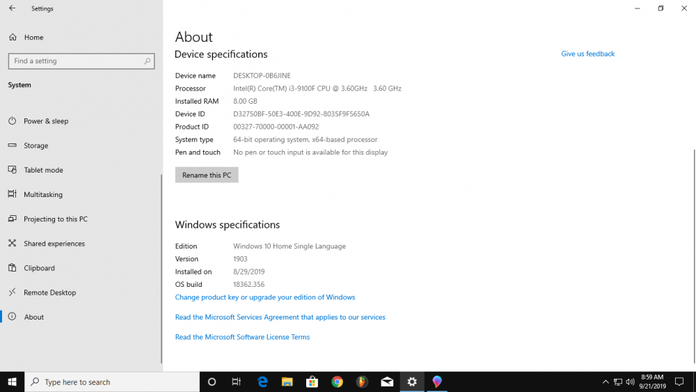

0 PhoeniXx Posted September 21, 2019 Author Share Posted September 21, 2019 (edited) Thanks for all the answers, Here are a few things - pc specs details.txt - This is the condump when i joined the game and it crashed its from before i could join any server details2(jay3).txt - This is once i tried to join jay1( but instead joined jay3 due to full server) and it got crashed after like 5-7 mins @captnconcretei will try the things in that video maybe after sometime Last valid renderer @RedBaird Edited September 21, 2019 by PhoeniXx Quote Link to comment Share on other sites More sharing options...

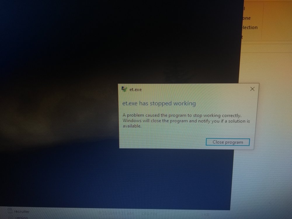

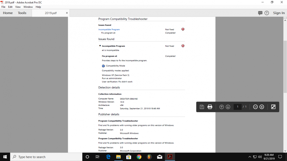

0 PhoeniXx Posted September 21, 2019 Author Share Posted September 21, 2019 (edited) This is what happens when I start the game... @RedBaird tried the windows compatibility testing - These are the results and game still crashing EDIT - Ran ET as administrator but still crashing 😕 Edited September 21, 2019 by PhoeniXx Quote Link to comment Share on other sites More sharing options...
0 kajto3 Posted September 21, 2019 Share Posted September 21, 2019 (edited) So that graphics card shown in lastvalidrenderer thing is the one you have? Did you set ET to use nvidia in nvidia panel or it chose nvidia by default? Did u try to run ET with Intel? You can send the crash information from Windows - it should be generated somewhere if it crashes like this but I dont remember where. I will try to come up with something else when Im on my PC. The thing that it crashes the same way with ETL as well is weird - ETLegacy fixes the vast majority of incompability issues on latest systems with ET, so it seems rather like a system issue. Did u try running other games? A couple with quake3 engine would be even better. Edited September 21, 2019 by kajto3 Quote Link to comment Share on other sites More sharing options...
0 PhoeniXx Posted September 21, 2019 Author Share Posted September 21, 2019 9 minutes ago, kajto3 said: So that graphics card shown in lastvalidrenderer thing is the one you have? Did you set ET to use nvidia in nvidia panel or it chose nvidia by default? Did u try to run ET with Intel? You can send the crash information from Windows - it should be generated somewhere if it crashes like this but I dont remember where. I will try to come up with something else when Im on my PC. Yea it chose Nvidia by default I didn't alter any settings.. Also nope I didnt run ET with Intel Quote Link to comment Share on other sites More sharing options...
