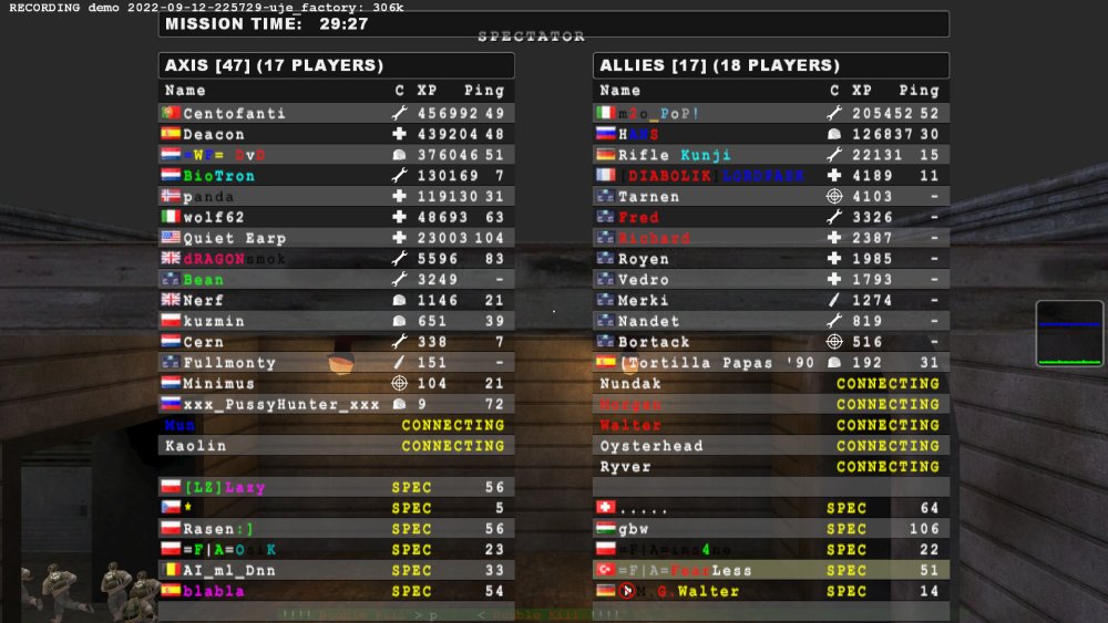

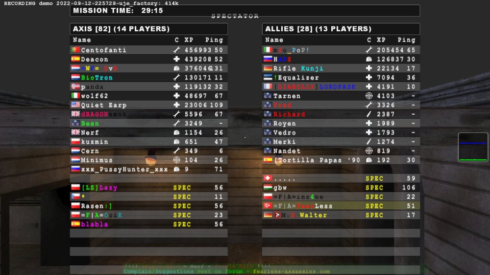

13 vs 5
Just an example. If the teams are not working to equalize , if the admins are afk, this creates a complete unbalance for the teams.
Sometimes teams fix it by nice people, sometimes admins try to fix it using !putteam.
Most of the time normal people don't really care about team balance, just play, kill and die!
Sometimes it takes 1.5-2 minutes for bots to connect to the game!
  • Senior Member
1 minute ago, mehmet said:
13 vs 5
So if it can be on both teams, and more than 3 bots connecting at one time, it must be related somehow to how many players are connected to the server. Maybe. Since it is less on Jay3, where less players are connected all the time than on B2, considering bots
