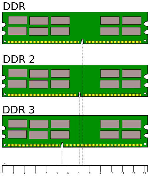

Just want to put this out there if your going with a DDR4 board when DDR5 comes out you will be outdated next year cause DDR4 is a isolated memory buffer not reverse compatible like DDR1-3 which is from what I understand Reverse compatible with DDR5 when it comes out https://en.wikipedia.org/wiki/DDR5_SDRAM
  • Confused 1
true, but it will be expensive still, besides, even with ddr4 your memory is fast enough, i still use ddr2, serves me well
  • Confused 1
Well some of use never upgraded to DDR4 for this reason to carry over parts ;)
  • Confused 1
True but DDR5 comes/goes with Ryzen zen 3 4000 at end of this year or early next year. Like in the older days at start the Ram and Mainboard are quite expensive and the question is when he want a new rig.
I don't understand. DDR-DDR3 were/are not backwards compatible. There's pinout differences, voltage differences, and most importantly the socket...
Edited by Xernicus
+for example and grammar fixes
