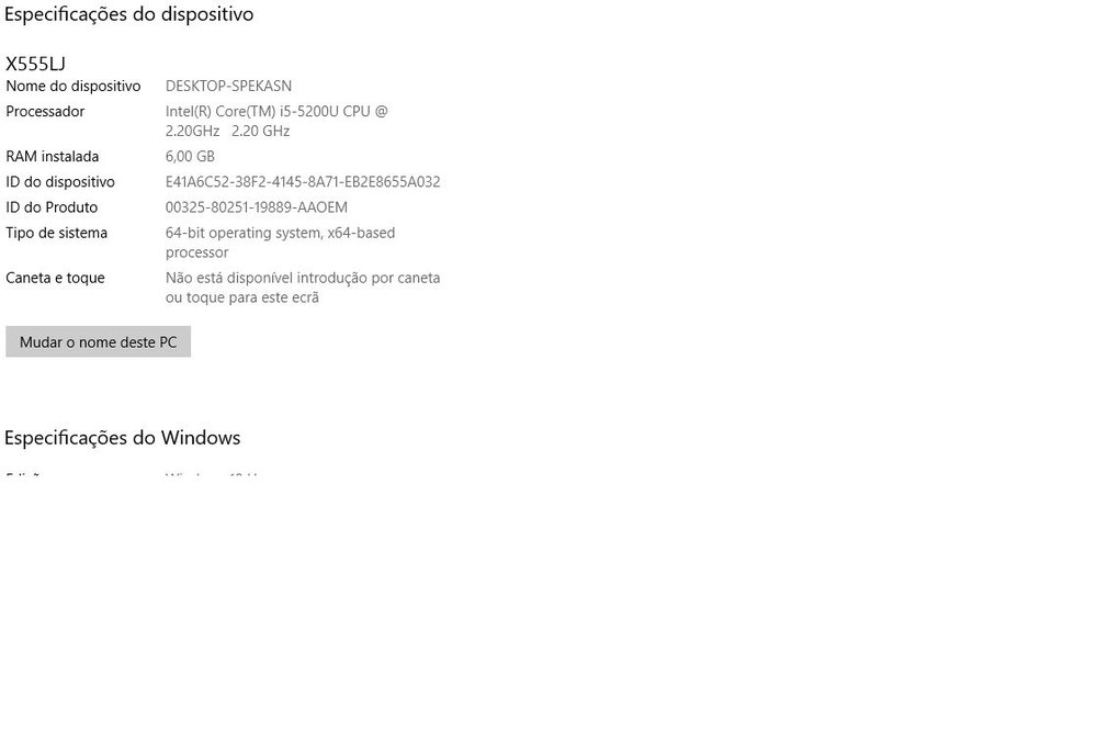

  • CPU:
  • RAM: 6 GB
  • Graphic Card: https://www.geforce.com/hardware/notebook-gpus/geforce-920m
  • Monitor: 1366x768
  • Internet connection and speed: Cable 8-12MB
  • Game graphics: Performance
  • What resolution you play with: 1024x768
  • What Sensitivity: 27
  • What Crosshair: stock
  • What FOV you want: stock
