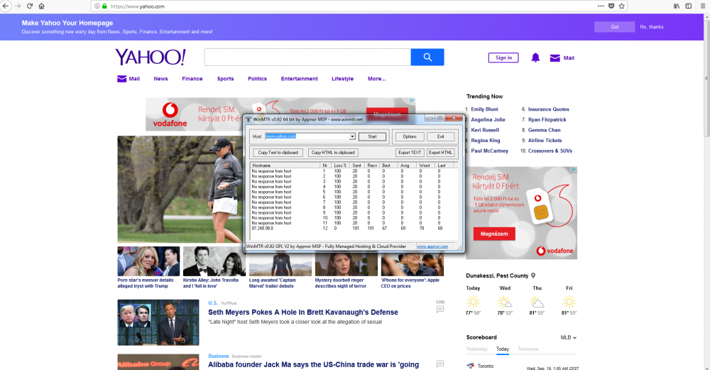

Senior Member Vindstot Posted March 29, 2018 Senior Member Share Posted March 29, 2018 Hello Im having a strange (or as Smiley said weird) problem while getting info from winMTR. You can see it on the attached file. Im not lagging on the servers more than Im supposed, having 125fps many times, so I dont know the effects of this issue. If any question is needed to be answered to solve it, Ill try to answer them. Thanks! 1 Quote Link to comment Share on other sites More sharing options...
ed_ Posted March 29, 2018 Share Posted March 29, 2018 Your router blocking ping requests. (firewall) 2 Quote Link to comment Share on other sites More sharing options...

Xernicus Posted March 29, 2018 Share Posted March 29, 2018 Re-enable that Firewall. Basically your router and potentially your ISP is blocking ICMP (ping) requests. Not a big deal, and not necessarily related to your lag... as you can see, that last hop (the server) is still responding just fine, which means that your packets are getting to the destination as intended, albeit with 1 dropped packet.Disabling firewall never solves the problem, just mitigates it (if it is the prob) and then all of your ports are open for everyone and anyone to exploit.Port forwarding could possibly solve this issue, but would be good to know what brand/model of router you use and whether you have any third party antivirus/firewall software such as BitDefender, ZoneAlarm, Comodo, etc (...especially Comodo. That can be a PITA, it works too good. )I am curious if tracert works (my guess is it won't). Open command prompt and type tracert jay3.clan-fa.com Your output should look something like this: C:\Users\Xernicus>tracert -d jay3.clan-fa.com Tracing route to jay3.clan-fa.com [178.63.72.170] over a maximum of 30 hops: 1 <1 ms <1 ms <1 ms 192.168.0.1 2 7 ms 6 ms 7 ms 63.231.10.65 3 8 ms 7 ms 7 ms 71.217.186.1 4 7 ms 7 ms 9 ms 67.14.41.190 5 48 ms 29 ms 7 ms 129.250.9.133 6 7 ms 7 ms 8 ms 129.250.5.133 7 8 ms 17 ms 32 ms 129.250.2.44 8 83 ms 76 ms 76 ms 129.250.4.14 9 87 ms 94 ms 75 ms 129.250.3.207 10 186 ms 158 ms 197 ms 129.250.2.5 11 185 ms 158 ms 158 ms 129.250.6.207 12 160 ms 190 ms 161 ms 213.198.82.130 13 168 ms 168 ms 167 ms 213.239.245.217 14 167 ms 167 ms 169 ms 213.239.229.242 15 162 ms 161 ms 162 ms 178.63.72.170 Trace complete. 2 Quote Link to comment Share on other sites More sharing options...
Senior Member Vindstot Posted March 29, 2018 Author Senior Member Share Posted March 29, 2018 @Kiba Only the "108.61.21.94" worked and got different result. See first SS. Tried with 108.61.21.94:27960 and jay3.clan-fa.com:27960 as well, I get a message: Unable to resolve hostname @Xernicus I tried tha command prompt thingie, see 2nd SS. Those thing next to asterixes mean something like: no answer to request before deadline. I only have Avast that could interfere. Avast had problems with different stuffs before. And Firewall was immediately re-enabled. By the way, thanks the answers Quote Link to comment Share on other sites More sharing options...
