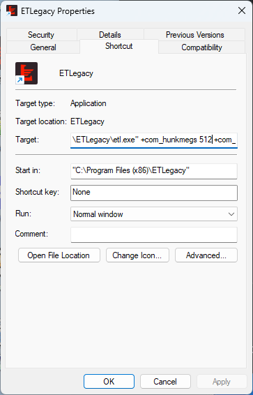

I added this +com_hunkmegs 512 +com_soundmegs 192 +com_zonemegs 192+com_hunkmegs 512  to that Target on etlegacy shortcut. But as @RendeL asked about cfg's. Next step would be to post those if those changes doesen't fix the problem.
