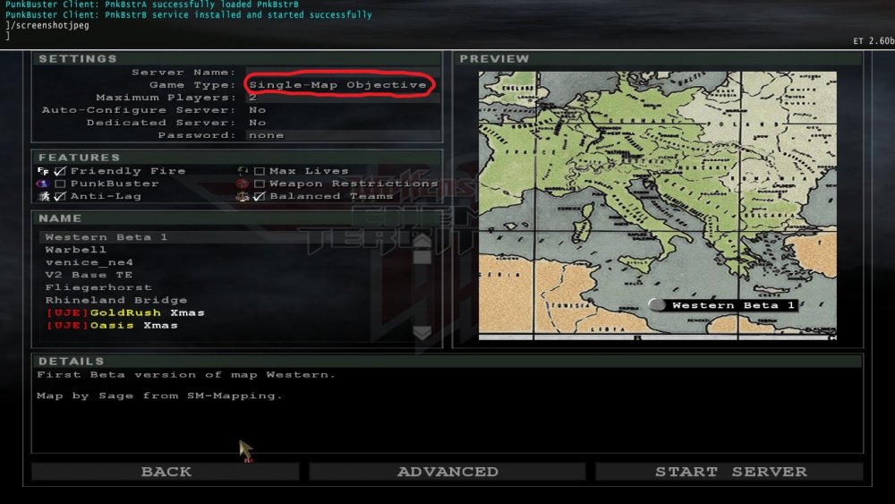

Over the years playing on our servers I collected quite a lot of maps in my etmain (far more than 100).
When hosting a game (via 'Host Game' -> 'Single Map Objective') in my home network I can see and choose a lot of them (about 55) - but many are not available.
Does anyone know why that is or even better how to change it?

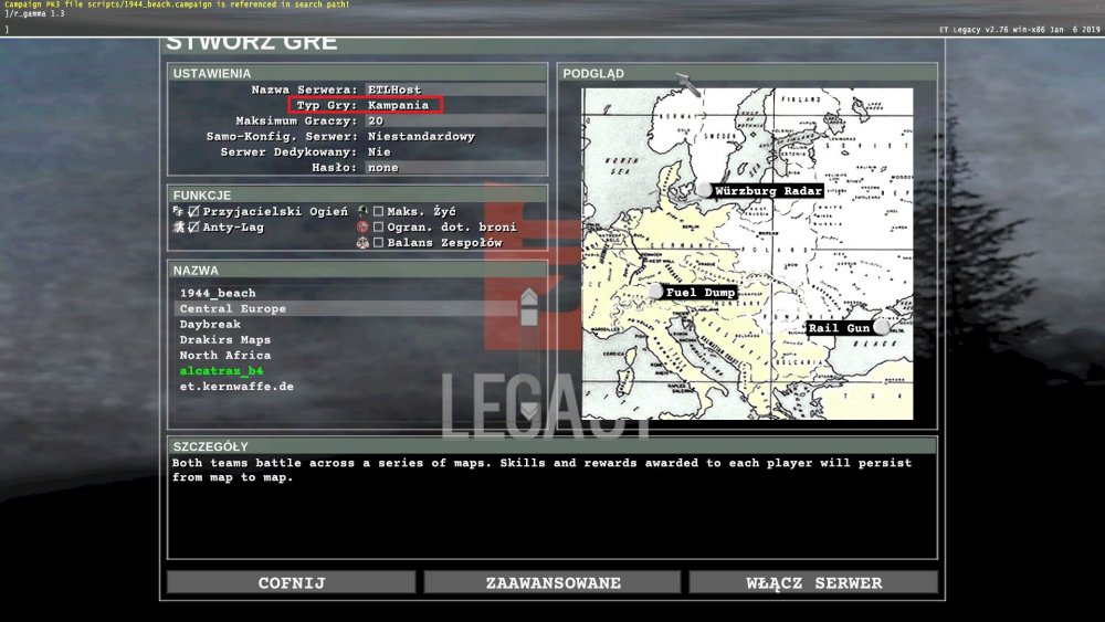

Can you share a Screenshot of the menu you have after clicking host game?
Do you have directly the list of all maps or a "campaign / single map" selection?
I had this problem too at the beginning, and when choose " single maps" there was just the classic ones. I don't know what I do, but now I don't have campaign selection anymore, I have directly all the maps I have on my etmain.
If you try to host a game with one of the classic maps you have, then in the map try to change for another. Do you have more maps avaible?

The "Game Type" selection doesn't seem to be the problem. As stated in my question I chose the "Single Map Objective" mode and not "Campain",
"Stopwatch" or any other (@Snuffs99 @FILIPE @DeKing). See Screenshot below:
1553136622_HostGame-SingleMapObjective.thumb.jpg.bc6cbb35511b5224b0bc9db2f805e038.jpg

  • There are 117 .pk3-maps in my etmain. Not only the classical ones, also F|A's, UJE's, MLB's, etc... (and all fully functional, no tmp files @FILIPE)
    The list in the "Single Map Objective" menu shows the last 56 of them (in correct alphabetical order starting from the bottom W - "Western Beta 1" going up to M - "Minastirith")
  • When starting a local server those maps are also the only ones to choose from in the Referee menu.
    I can change into those maps, it doesn't effect the list though @RendeL @DeKing
