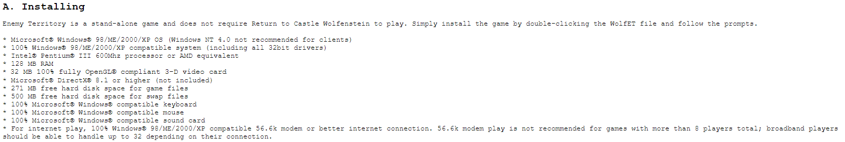

0 ElEl Posted September 26, 2019 Posted September 26, 2019 On 9/25/2019 at 11:44 PM, captnconcrete said: im pretty sure no direct x and et wont work..maybe im just a fool but ..im pretty sure. Expand On 9/25/2019 at 6:53 AM, Xernicus said: Why is DirectX being mentioned? ET uses OpenGL. Two completely different APIs. Expand https://www.wolffiles.de/etmanual/en/Tech Help/Information/DirectX.htm I found this and it's from the ET manual. Is it outdated @Xernicus? Also this: But if it was an issue with DirectX then wouldn't ET just refuse to open? I guess you could try reinstall DirectX, then try a driver rollback, then try on board graphics. I'm still thinking the issue is a faulty graphics card though. Quote

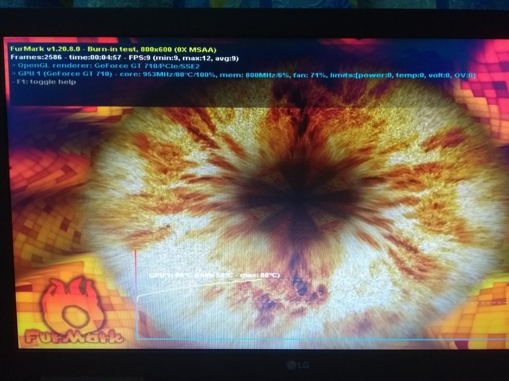

0 PhoeniXx Posted October 2, 2019 Author Posted October 2, 2019 (edited) THis is the AIDA stress test... it didnt crashed but was working a bit slower than usual @Snuffs99ran the furmark for 5 :47 mins It didn't crash Edited October 2, 2019 by PhoeniXx Quote
0 seriallnumber Posted October 2, 2019 Posted October 2, 2019 On 10/2/2019 at 3:53 PM, PhoeniXx said: THis is the AIDA stress test... it didnt crashed but was working a bit slower than usual @Snuffs99ran the furmark for 5 :47 mins It didn't crash Expand You did connect into server , but your ping was 15 and you times out after that Quote
0 Snuffs99 Posted October 2, 2019 Posted October 2, 2019 (edited) Hi mate, thanks for doing the tests. Good news is your CPU, HDD, Mobo etc all seem fine temp wise looking at the AIDA figures, will be higher than normal as your system is effectively being hammered to 100% usage. However looking at your Furmark results although it didn't crash you only achieved a max of 12 FPS which is pretty shit tbh @ 800x600. . One thing about the GT710 is if i remember correctly it required a specific driver for windows 10, i installed a GT710 in my mothers PC just over a year ago and i did have issues with the driver as it had to be a specific one, i'll log on to her system and grab the driver version because i do know i had issues with the 710 not being windows 10 compatible. If you have onboard gfx remove the 710 (its a crap card anyway and obsolete) and try running ET with the onboard, in the mean time i'll log on my mothers PC and see what her Furmark results are @800x600 and more importantly what driver number she has installed, i'm almost certain it is the driver being your issue, kicking myself for not twigging earlier tbh. i assume Dare installed the latest one but like i say it has to be a specific one to work correctly in windows 10 otherwise it does not work properly. She is home now so i'll log on her PC now and look mate, more to follow. ***EDIT Ok so i've logged onto my Mums PC and luckily i left the Nvidia driver on the desktop (yay me) The driver i used to get her GT710 all working properly is 368.39-desktop-win10-64bit-international-whql which can be downloaded from https://www.geforce.com/drivers/results/103913 You will notice its about 3 years old Version 368.39 - WHQL Release Date Tue Jun 07, 2016 Operating System Windows 10 64-bit Language English (US) File Size 351.05 MB I think Microshaft sorted a newer driver in the creators update as when i check the current driver version of my Mums GT710 in device manager its changed to Again though its an older driver from 2017 so for the sake of keeping things all the same totally uninstall everything Nvidia wise from your system then install the 368.39 driver and take it from there. Fingers crossed all will be good but if not i think i'll have to log on to your PC via Teamviewer mate and see if i can get it working properly. Let me know how it goes and if needs must i'll log on like i say and see if i can fix it, much quicker that way as i can try 10 things in the time it takes me to type out 1 thing for you to try. Good luck ***EDIT Edited October 2, 2019 by Snuffs99 3 Quote
