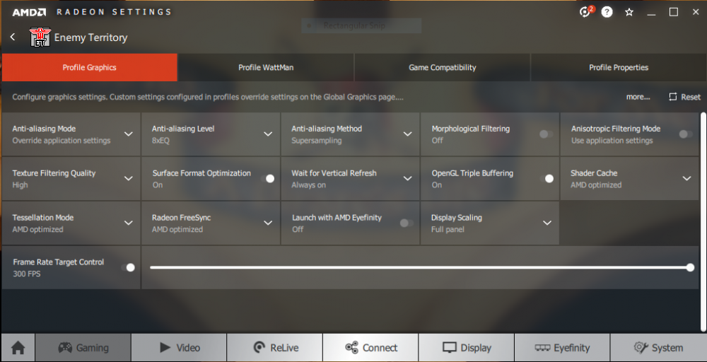

Beeshbum Posted January 23, 2019 Share Posted January 23, 2019 Hard to believe, but I upgraded to a better gaming card for another game I want to play, and now ET performance sucks. Old Card: nvidia Ge Force GTX 260 New Card: XFX Radeon RX 580 Previously, gameplay was incredibly smooth, always maxed out FPS regardless of the environment, etc. Had no issues at all. Now, with the new card, in any sort of action environment, I'm dropping to like 10 or less FPS. I don't understand what's going on here. I've checked/disabled a lot of the settings in the Radeon app, even turned off the ET profile it set up on its own, and nothing I do seems to make anything better. Anyone have any ideas? I find it hard to believe that a card this powerful can struggle with an old game like ET but not struggle with a newer, more powerful game. I have to believe it is something with the settings of either the card or the game, but I don't know what to do since everything I tried is not making a difference. Any help is greatly appreciated. Quote Link to comment Share on other sites More sharing options...

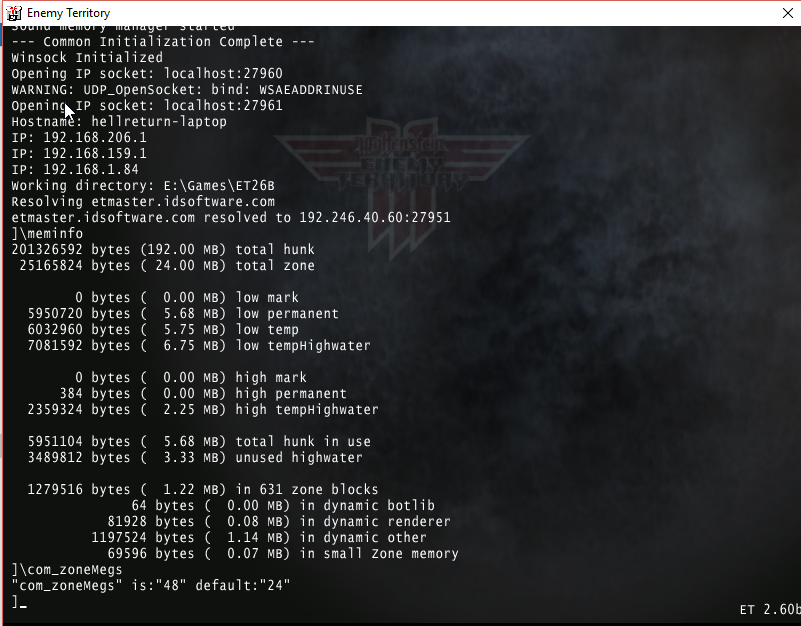

Chuckun Posted January 27, 2019 Share Posted January 27, 2019 Maxpackets 50? There's a formula for calculating perfect maxpackets but for now, try maxpackets 100 as a simple check to see if that's causing you issues. Also I don't see any com_ settings in your config? May be you need to increase your com_hunkmegs etc? 1 Quote Link to comment Share on other sites More sharing options...
Beeshbum Posted January 27, 2019 Author Share Posted January 27, 2019 52 minutes ago, Chuckun said: Maxpackets 50? There's a formula for calculating perfect maxpackets but for now, try maxpackets 100 as a simple check to see if that's causing you issues. Also I don't see any com_ settings in your config? May be you need to increase your com_hunkmegs etc? This cfg is at least a decade old. I'm not smart enough to know perfect settings anymore :). Ill try the maxpackets increase. I have no idea what those other settings are you mentioned! Quote Link to comment Share on other sites More sharing options...

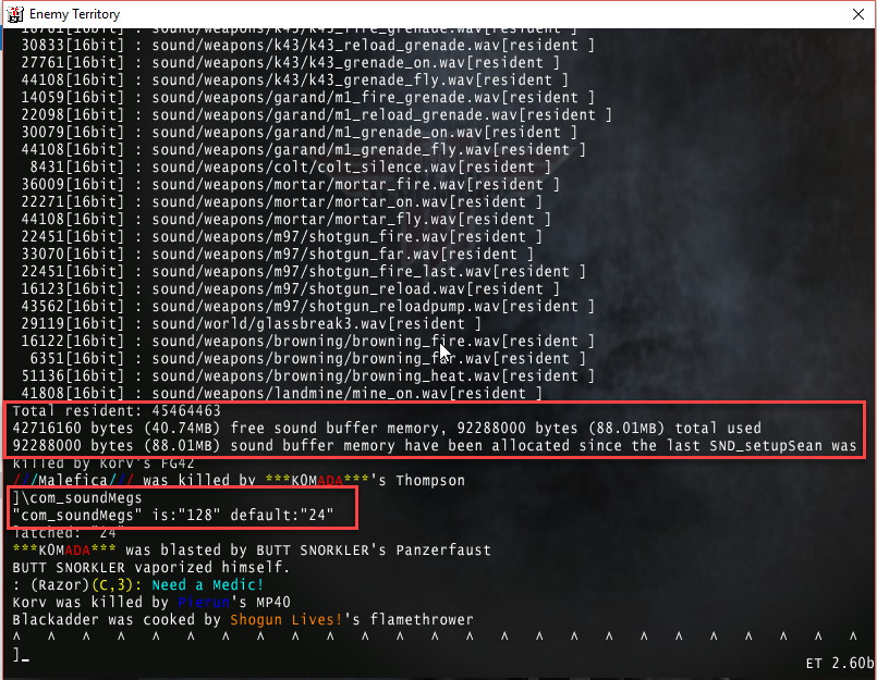

Lenovo Posted January 27, 2019 Share Posted January 27, 2019 com_hunkmegs (default 56) for 2003 , we are on 2019 try, 256 or 512 com_zonemegs (default 24) try 128 com_soundmegs (default 24) try 64 cl_maxpackets (default 30) try 100 seta rate (default 5000) try 34000 r_swapinterval "0" (v-sync off) com_maxfps (default 85) try 125 r_displayrefresh (default 0) try 60 ---------------------------------------------------------- try this commands seta r_highQualityVideo "1" seta r_normallength "0.5" seta r_trisColor "1.0 1.0 1.0 1.0" seta r_primitives "2" seta r_railSegmentLength "64" seta r_railCoreWidth "1" seta r_railWidth "64" seta r_facePlaneCull "1" seta r_swapInterval "0" seta r_textureAnisotropy "1" seta r_textureMode "GL_LINEAR_MIPMAP_NEAREST" seta r_finish "1" seta r_dlightBacks "1" seta r_dynamiclight "2" seta r_drawSun "1" seta r_fastsky "0" seta r_ignoreGLErrors "1" seta r_flares "0" seta r_lodbias "-2" seta r_lodCurveError "10000" seta r_ignoreFastPath "0" seta r_smp "0" seta r_subdivisions "1" seta r_simpleMipMaps "0" seta r_customaspect "1" seta r_customheight "768" seta r_customwidth "1024" seta r_fullscreen "1" seta r_oldMode "" seta r_ignorehwgamma "0" seta r_overBrightBits "0" seta r_depthbits "24" seta r_stencilbits "1" seta r_stereo "0" seta r_colorbits "32" seta r_texturebits "32" seta r_detailtextures "1" seta r_roundImagesDown "1" seta r_picmip "0" seta r_clampToEdge "1" seta r_ext_texture_env_add "1" seta r_nv_fogdist_mode "GL_EYE_RADIAL_NV" seta r_ext_NV_fog_dist "0" seta r_ext_texture_filter_anisotropic "1" seta r_ati_fsaa_samples "1" seta r_ati_truform_pointmode "GL_PN_TRIANGLES_POINT_MODE_LINEAR" seta r_ati_truform_normalmode "GL_PN_TRIANGLES_NORMAL_MODE_LINEAR" seta r_ati_truform_tess "1" seta r_ext_ATI_pntriangles "0" seta r_glIgnoreWicked3D "0" seta r_ext_compiled_vertex_array "0" seta r_ext_multitexture "1" seta r_ext_gamma_control "1" seta r_ext_compressed_textures "0" seta r_allowExtensions "1" seta r_glDriver "opengl32" seta r_inGameVideo "1" seta r_gamma "2.4" seta r_intensity "1.5" at the end of the cfg add this command: vid_restart 1 Quote Link to comment Share on other sites More sharing options...

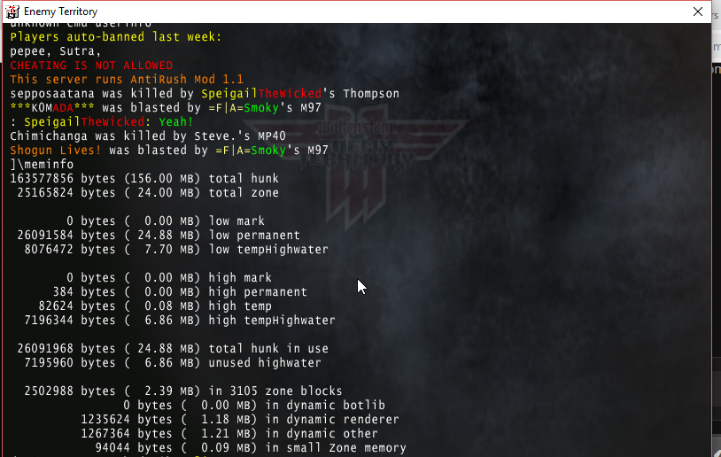

Administrators daredevil Posted January 28, 2019 Administrators Share Posted January 28, 2019 5 hours ago, Lenovo said: com_hunkmegs (default 56) for 2003 , we are on 2019 try, 256 or 512 ET will not use more then 256 Hunks. Have u seen map where u will use more then 256 hunk megs? Please provide stats. I just don't want people to use 512Mb hunk meg when they have just 4GB or 8GB RAM on their machine. It would cause reverse effect i.e. lag when they have 4GB ram and are using 512Mb hunk. Thanks On 1/23/2019 at 9:13 AM, Beeshbum said: Old Card: nvidia Ge Force GTX 260 New Card: XFX Radeon RX 580 Please check your openGL drivers. OpenGL drivers play big role in FPS for ET. 1 1 Quote Link to comment Share on other sites More sharing options...

Lenovo Posted January 28, 2019 Share Posted January 28, 2019 I sometimes use 1024 hunkmegs and I have only 4gb of ram ddr2 very old, but I shoot very well and I have no lag, the important thing is to have the free ram, of course you use 3 gb for all open programs, then I can give you reason I give an example: currently without Enemy Territory open my ram available on 4gb, (it is 3 GB, so if I use com_hunkmegs 512 or 1024 I have no lag Quote Link to comment Share on other sites More sharing options...

Aniky Posted January 28, 2019 Share Posted January 28, 2019 5 minutes ago, Beeshbum said: Bumped maxpackets to 100. Didn't notice much of a difference and FPS stayed the same, around a constant 60. On the old nvidia card I was constantly around 166 or something like that. Not sure exactly what display refresh is or where to find it, but I have just basic acer monitors. Probably a 60hz refresh if that's the same thing? Anything I can try next after the maxpackets? Not sure what other config items posted here are relevant to my exact setup. Thanks! It would come down more to the ati settings, u can check at your gpu control panel how much display refresh rate u have. Check a bit on the forums and Google for which settings to keep for ati and which ones to turn off. Quote Link to comment Share on other sites More sharing options...
