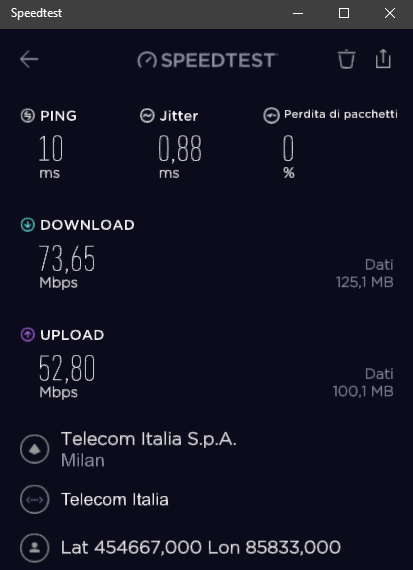

after 3 days of reboots and factory reset
having many more packages lost than usual
of course I telephone the operator of my ISP and it is like a madman and threatening to block the payments of bills from the bank
as a miracle the line returns to work better than before the packet loss problems, and with tests in "wi-fi" strange for my upload parameters blocked at 21MB
all Italian ISPs are a legalized scam, normal users who are not in front of the 24H PC are not aware of these bandwidths, and these packet loss, and they think that their line is enough that the web pages work, then it's ok, they are wrong.
1113246307_Speedtest7giugno2018dopolatelefonatadireclamoatim.PNG.762f663dffdcf3852058e0fb62dfedbb.PNG
my Router set to 80MB in "download" and 20MB in "upload"

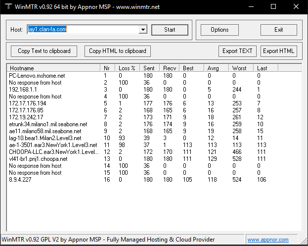

here is my wonderful WinMTR test while I'm in Jay one
or Italian speaker: 00.36 udc-gmt +1
