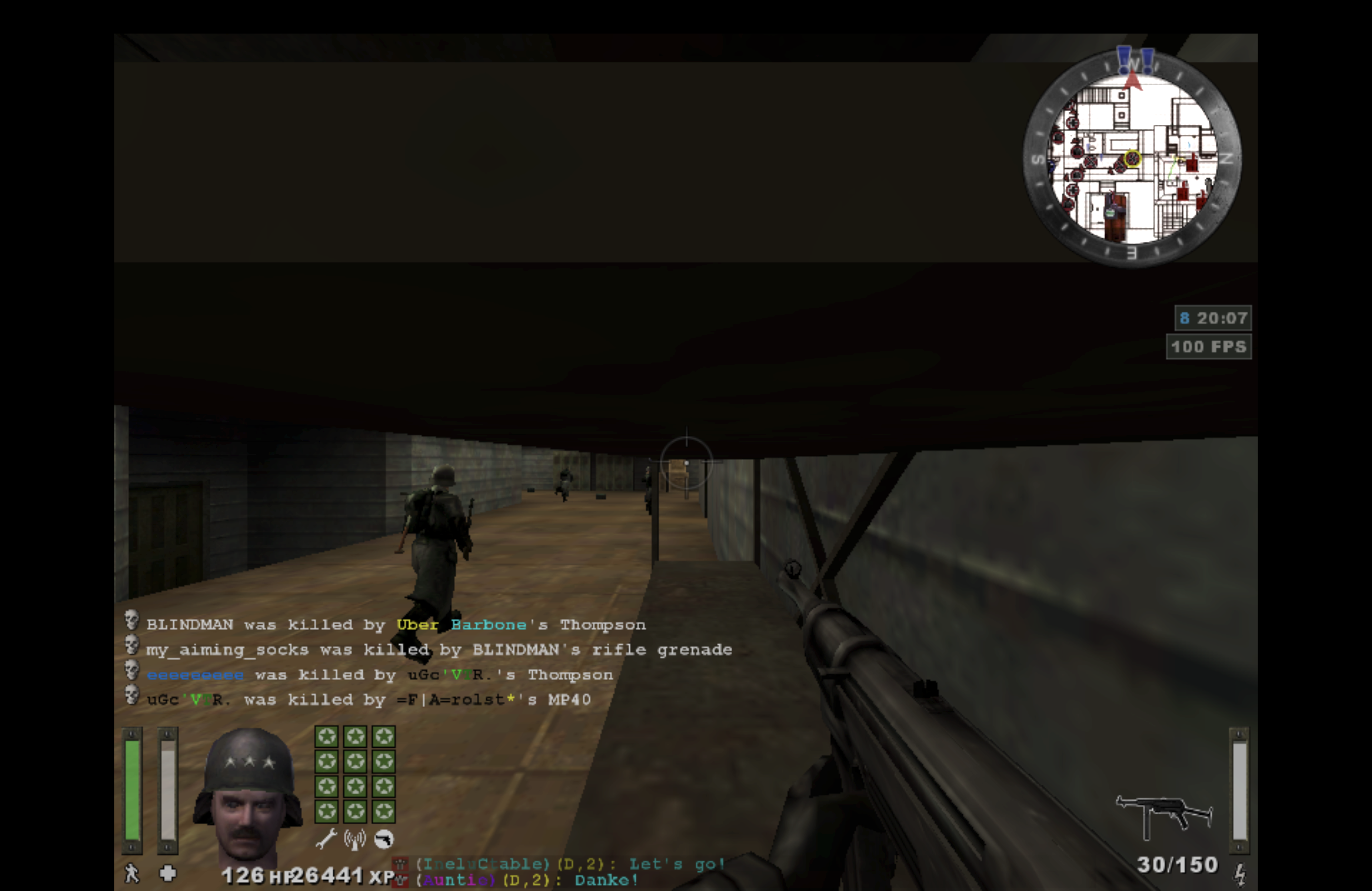

On the last part of the map Flame Guards, the final axis spawn has a bug where there is a chance to spawn in a shelving unit along the wall and you're stuck there unless you self-kill or someone pushes you out. Suggestion would be to get rid of the shelf =]
The broken spawn point was removed, and the final countdown was fixed the same way as in Daybreak:
flame-guards.script
Edited by TomekKromek
