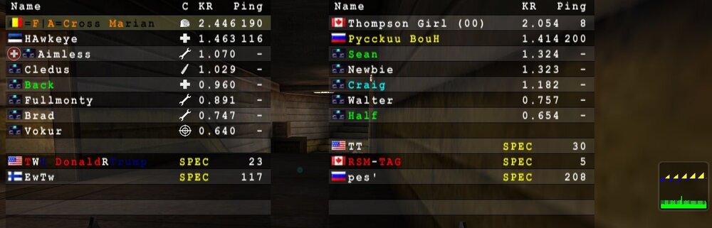

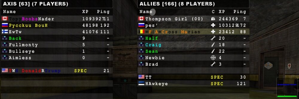

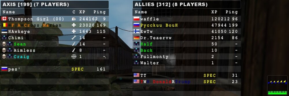

I did run a couple of MTR diagnostics with WinMTR (hours apart), and it looks pretty bad around 3 hops (in orange below). But I don't know what the figures were like before the issue started. I also took some ss of my lagometer.

Lagometer when I get my "normal" ping (between 80 and 95):
