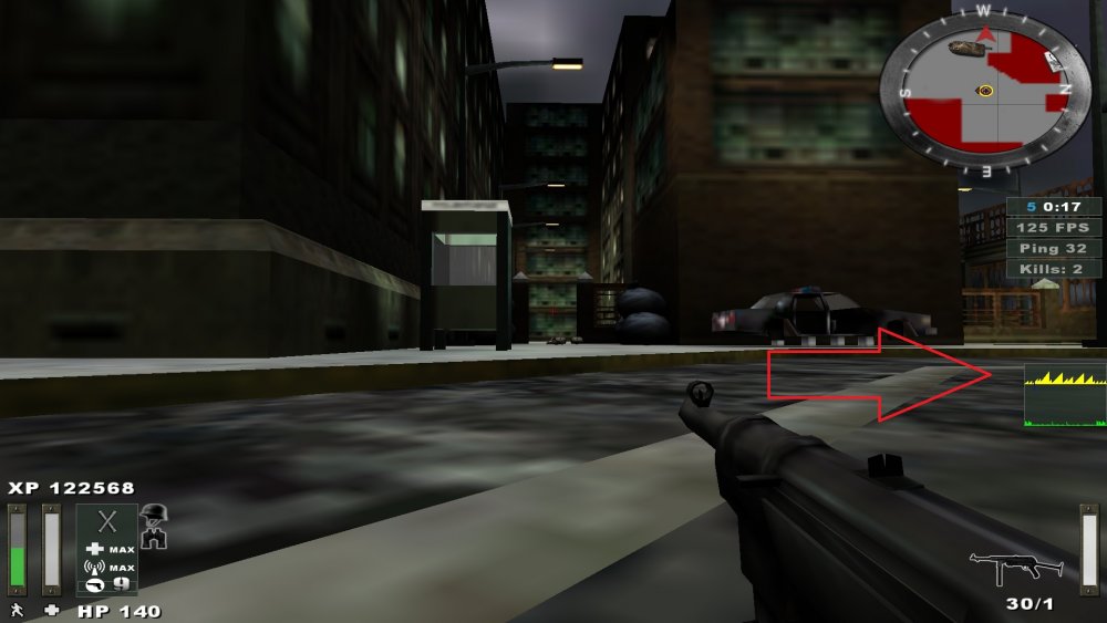

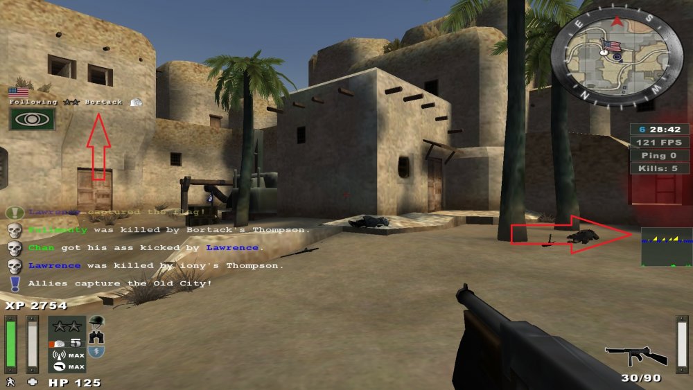

server (NQ1) works great for me, no lags whatsoever my lagometer is straight like piece of plywood
