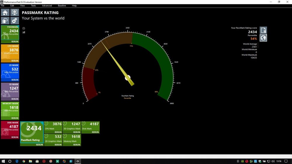

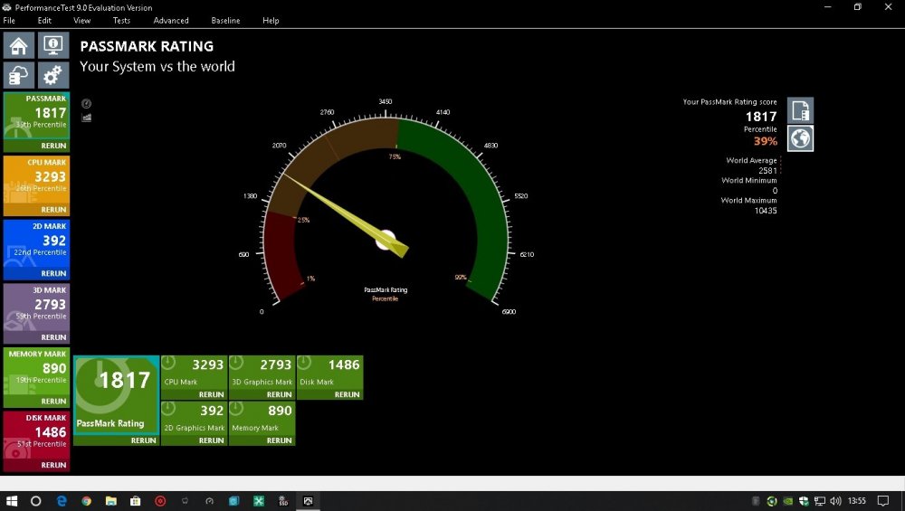

Laptop test
PC FIXED test

is it worth the investment  leno .. i always wanted to upgrade to ssd but my pc is so old it farts dust.
I can confirm that the limitation I had against 70% of the players was caused by the old hard disk at 7200 rpm and not caused by the connection delay.
after 3-4 days of testing on Enemy Territory I can confirm that the SSD, despite my motherboard only supports 3 GB / s, is definitely a joker in my favor, my accuracy has increased, the projectiles come out much faster from rifle, I do not know how to explain it, but I've definitely improved.
I emphasize that in this computer I have limits due to an old technology

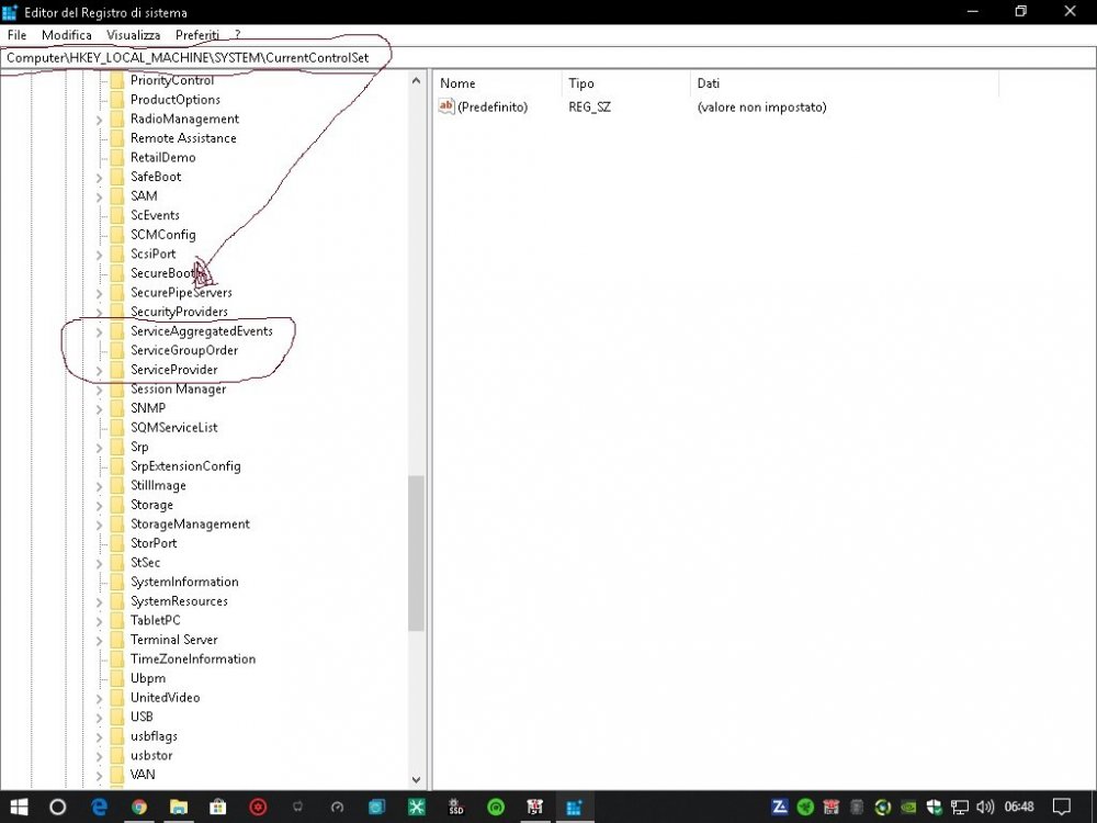

HKEY_LOCAL_MACHINE\SYSTEM\CurrentControlSet\Services
this destination does not exist in my win 10

You're running regedit as an administrator? Maybe there's a permissions issue with the filesystem or something happened with an overzealous registry cleaner... This exists on all versions since 2K, so something is wrong if it's not there.

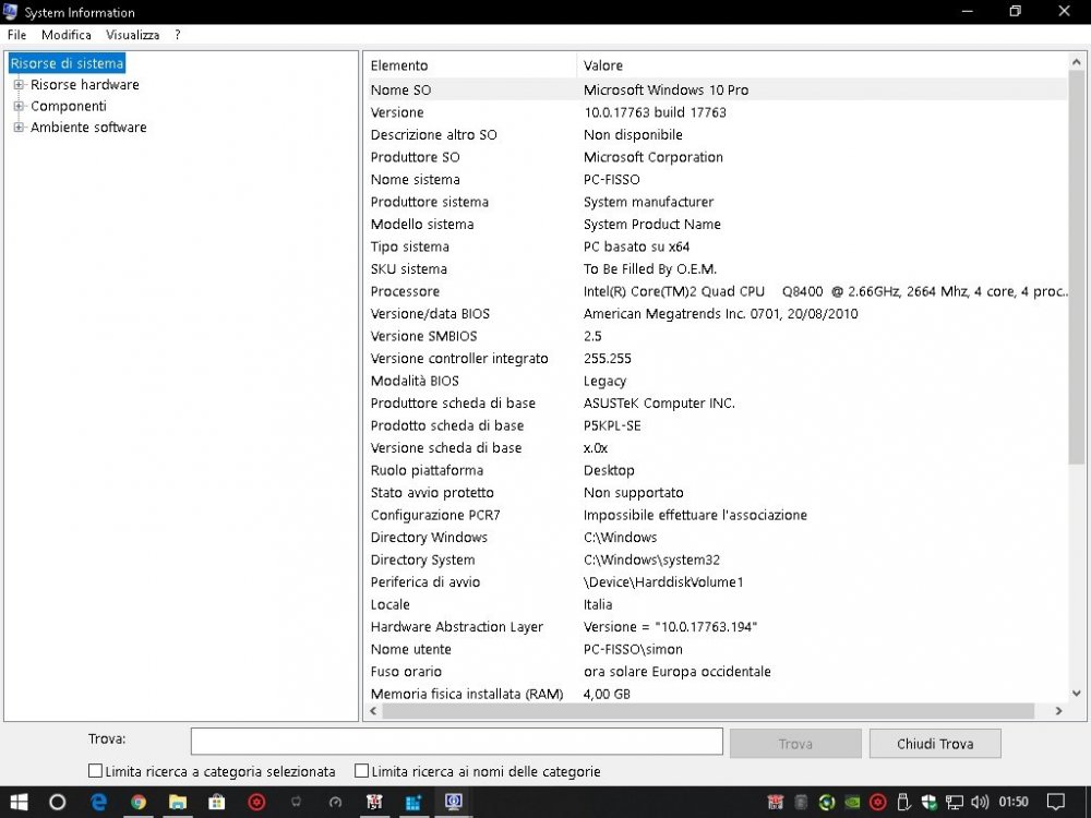

Can you look in System Information from search box and tell us the Version of Windows 10 your using
Can you tell us if the system came with Win10 or upgraded from 7 or 8

I've just reinstalled from scratch, I must point out that there is no option to enable AHCI from the bios
the only options are these
IDE / SATA
disable
compatible
enhanced
Yes you are correct. I did some more digging and that motherboard does not allow for AHCI. It's not even hackable.
https://www.bios-mods.com/forum/Thread-Asus-P5KPL-SE-AHCI-Mod
There's people that are apparently hacking the P5K and P5KPL-AM to enable AHCI with custom bioses but its not an option for the P5KPL-SE. Sorry I didn't see this sooner.
