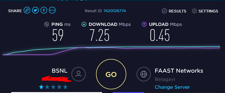

Carbonautics Posted July 24, 2016 Author Share Posted July 24, 2016 This is a speed test by speedtest.net, someone request it for my cvar in cfg Quote Link to comment Share on other sites More sharing options...
Xernicus Posted July 24, 2016 Share Posted July 24, 2016 Alright, just acknowledging that I see this, let me see what I can do.Just give me a few hours, and I will have one made up for ya. Let me know if you want any binds included.OFC- If anyone else wants to chime in, with exp for low bandwidth configs, you're more than welcome 1 Quote Link to comment Share on other sites More sharing options...
Carbonautics Posted July 24, 2016 Author Share Posted July 24, 2016 You can add some binds with cool lines and sounds, i dont want any certain bind, you could add as you like, and take some days if you want, coz i have some exams, for 2 days, and wont be playing on et! And Thanks again Quote Link to comment Share on other sites More sharing options...
Xernicus Posted July 26, 2016 Share Posted July 26, 2016 Altered the ET config Annibal created for you, with graphics set to maximum per your request, and resolution changed to match your new monitor/video card.Changelist: -Changed rate to better match bandwidth -Changed picmip and subdivisions values for "maximum" graphics quality-Changed sensitivity to 3.75 per last request -Added "Great Shot" bind to Insert, and "Thank you" bind for healer to Home.-Crosshair changed to 1Just copy to your JayMod folder, and /exec Carbon Carbon.cfgEdit: I can throw in colored name in your config too, if you would like. IMO, I think of black/grey when I see Carbon, so here is a simple tri-color version that I made up 1 Quote Link to comment Share on other sites More sharing options...

Carbonautics Posted June 25, 2018 Author Share Posted June 25, 2018 On 7/17/2016 at 10:23 AM, Carbonautics said: I just got a new Pc, so need a new cfg Core i3 3.5ghz Zotac GeForce Gt 610 synergy edition 1920*1080 Fov be 110 Crosshair1 And I have a dial up connection I couldn't group it in any its good for me no lags mostly,, SO anyone who helped thanks in advance WEll, I revived another dead topic man wtf, i feel so bad to do it so many times anyways. I currently have a cfg which i think isn't working for me anymore maybe I messed up a setting or something i can't really know, but anyway I wanted to make a 2018 cfg for myself but I failed. So I'm using some altered version of my current cfg. Core i3 3.5Ghz GT 610 2Gb ddr3 hynix 1080p crosshair 5 with cyan Note: I have a low (upload speed) adsl (coaxial cables) connection, here's a ss of my speeds (The server in the ss is somewhere 2-6km away from me not sure of the location) Additional : I always wanted a bind to change names (afk and normal) never solved the problem . 2] Visual settings dont really matter as long as I have 125-166fps it can be highest if i get min 125fps Not much picky-ness but any more tricks that could be helpful to me (I do not use f-ops so airstrike bind not needed ) Here is my current cfg if all this is already in you could alter the current to match the above autoexec.cfg If I have missed any info from myside please let me know I will provide it instantly. Quote Link to comment Share on other sites More sharing options...
