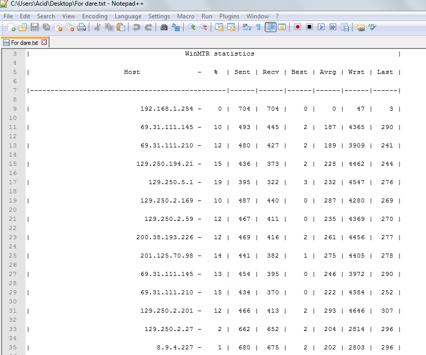

  On 6/15/2014 at 11:47 PM, AcidParadox said:
5ec7eee5775da8694b0b6ec507e312ec.png|
Good to see forums are back!
This is what I got  :rolleyes:
I told other members to post their results here too
I would suggest you should contact your ISP and show them this and get your internet fixed. 20% packet loss on your network is issue and hence you are seeing lag on jay1.

  On 6/17/2014 at 1:54 AM, yoyo said:
Everybody was complaining of lag on jay1 >.>
There's absolutely no packet loss on the server in your SS. With your ISP's servers however... very much so. I'd give them a call, and make sure they give what you are paying for. ;)
Not going to help :(    , I need to switch to pvt. ISP  from current one.
