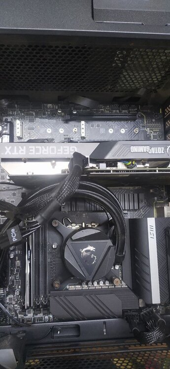

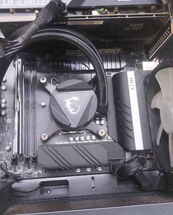

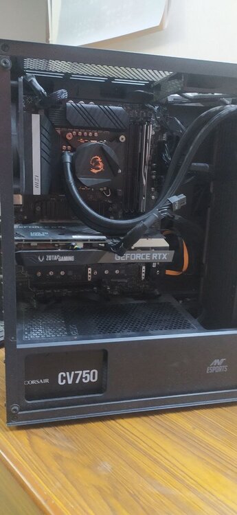

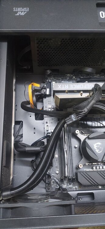

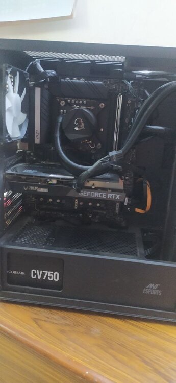

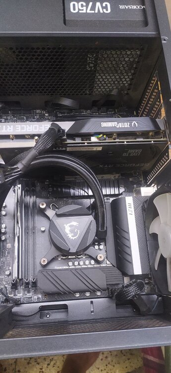

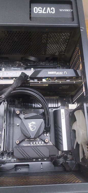

Leader RedBaird Posted June 9, 2024 Leader Posted June 9, 2024 (edited) I had thought that those two cables leading to the CPU were water-cooling hoses, but @tipsy says that he does not have water cooling. My sealed CPU water-cooling kit looks like that, but with a plain round "puck" atop the CPU. I had installed it. My kit has no fluid tank to refill. My two hoses lead off to a "radiator" on the back panel with a fan mounted on it. (It came with 2 fans, but I took one off for being too noisy. The pic below shows a very similar situation. It looks to me like two water-cables leading off somewhere. I see a tiny cable leading off to the motherboard, which is probably the power for the pump mounted on the CPU. Even when expanded, I cannot see if the power is properly plugged into the mobo. I believe that I can test my water pump by just touching it with a finger to see if it vibrating at all. And, I just realized that another pic shows the hoses plugged into what looks like a radiator. It does not look like my old-style radiator, though. It looks much more modern! 😄 We need more 'modern' opinions here... ⁉️ Edited June 9, 2024 by RedBaird wrong image the first time, then added another Quote
Element' Posted June 10, 2024 Posted June 10, 2024 (edited) 2 hours ago, RedBaird said: I had thought that those two cables leading to the CPU were water-cooling hoses, but @tipsy says that he does not have water cooling. It does not look like my old-style radiator, though. It looks much more modern! 😄 We need more 'modern' opinions here... ⁉️ You are right about that, @RedBaird! That definitely looks like a water cooler to me. Looks like a MSI MAG Series CORELIQUID 360R v1 if I had to guess 😄 PS. I am no expert on these things but the way the radiator is mounted seems odd to me. I think the tubes are recommended to go at the bottom, but I could be wrong. Edited June 10, 2024 by Element' observations 1 Quote
Platinum VIP -=HipKat=- Posted June 10, 2024 Platinum VIP Posted June 10, 2024 Those hoses go to a radiator so it has to be water cooled, otherwise that would be fans and there would be a large CPU Fan over the CPU 1 Quote
Leader RedBaird Posted June 10, 2024 Leader Posted June 10, 2024 3 hours ago, Element' said: PS. I am no expert on these things but the way the radiator is mounted seems odd to me. I think the tubes are recommended to go at the bottom, but I could be wrong. Some of the pics are upside-down. It looks like the radiator is on the front of the case, judging by the GPU mounting, presumably at the rear. Quote
Element' Posted June 10, 2024 Posted June 10, 2024 30 minutes ago, RedBaird said: Some of the pics are upside-down. It looks like the radiator is on the front of the case, judging by the GPU mounting, presumably at the rear. Going off this pic: (the right orientation)air could be getting stuck up in the line is what I mean. 🤔 If the tubes were going downward there would be no chance of air getting in the lines. 1 1 2 Quote
Leader RedBaird Posted June 10, 2024 Leader Posted June 10, 2024 (edited) 1 hour ago, Element' said: If the tubes were going downward there would be no chance of air getting in the lines. You mean like this guy recommends for AIO cooling systems, I presume. It looks like I installed mine with the tubes at the top. I may have to take mine apart and switche, AFTER I find the installation manual and check it again. 😄 I had never thought of "air in the lines" for a sealed system with no water fill-tank. Just a new thought: so, an air bubble in the lines might cause the pump to malfunctions, just as air in our blood would cause our hearts to be unable to pump blood? Air would stay in the top of the radiator and not be drawn back into the pump. Edited June 10, 2024 by RedBaird new thought 1 Quote

*Kiba* Posted June 11, 2024 Posted June 11, 2024 (edited) funny how he says it's not water cooled UNTESTED MSI MAG CORELIQUID 240R ARGB Performance Liquid CPU Cooler FOR PARTS https://www.ebay.co.uk/itm/186180110043 p.s i'm pretty sure i watched over 10 videos of this https://www.youtube.com/@GregSalazar here having to replace this mag cores a number of times they like to clogged up it would be a good idea to take this thing off and make sure it's not clogged up he had to even replace the news ones from the liquid they put in in the factor bc they got to hot Edited June 11, 2024 by *Kiba* 1 Quote
