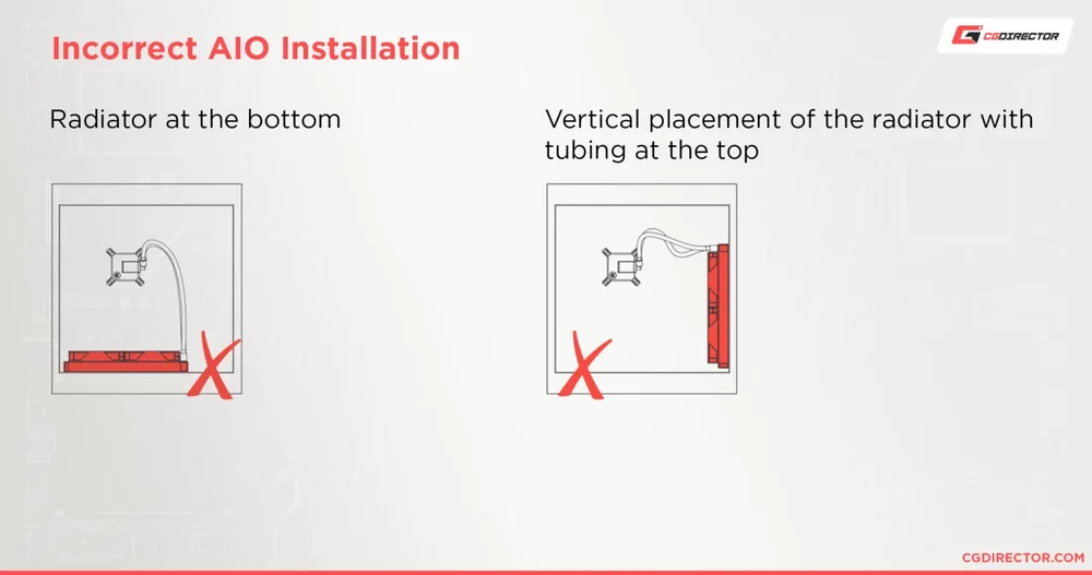

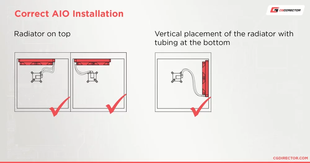

that is a liquid cooler and its mounted not so good. i agree with elements post.  it cannot perform like its supposed to  mounted like that. air can get trapped in the lines like that.

If an amateur had built it, the silicon paste between the pump and the CPU might be the problem.  That has happened with professionally assembled units, too. :(  (according to "The Internet".)
