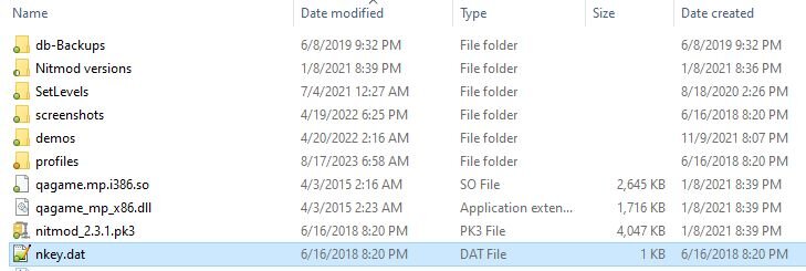

Here are the critical files in my nitmod folder.  There is also a "hunkusage.dat" file that is changed each time that nitmod is run.  You might see if that exists, too.
I created the first 3 folders and nitmod made the last three.  The "profiles" is the critical folder.

Do you see the first 3 files, as above, the qagame* files, and the nitmod_2.3.1, in your nitmod folder, with the same file sizes?

Where did you get nitmod_2.3.5.pk3?  I only have the 2.3.1 version in my Nitmod folder.  No wonder the file sizes are different.
No wonder that pk3 file size is different from mine!
My cgame_mp_x86.dll and ui_mp_x86.dll files are the same size as yours.
You could try moving those 3 files in the image to a different folder and then connect to FA-Fun1 again and see if it downloads the same files as I have.
