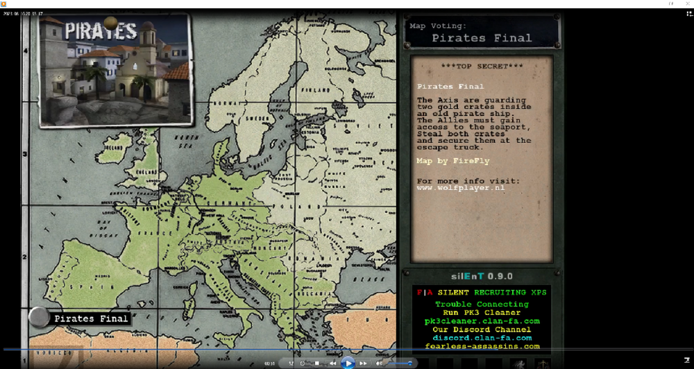

Elzozo Posted August 17, 2023 Author Posted August 17, 2023 (edited) I taked some images of gameplay in a normal (Silent or jaymod) server which I can connect without difficulties. This is what I talked about. The n!tmod screen is quite different, though, with a black background, description on the left, etc. Edited August 17, 2023 by Elzozo Quote

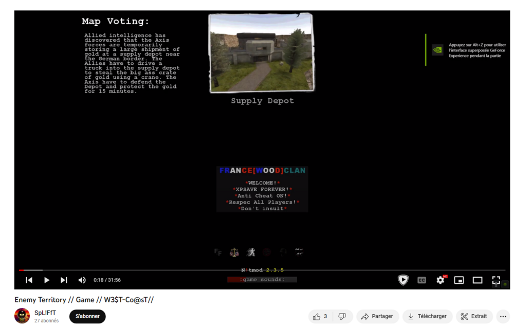

Elzozo Posted August 17, 2023 Author Posted August 17, 2023 This image, taken from a YouTube video, shows what it looks like when I'm locked. Quote
Leader RedBaird Posted August 17, 2023 Leader Posted August 17, 2023 Does that same image appear when you try to join the FA Nitmod? If so, then it might be that a *.pk3 file downloaded from the Wood Clan is either corrupt or is interfering with all attempts to connect to all nitmod servers. If that is not exactly the same image, then it could be from another server, but the principle is still the same. 1 Quote
Elzozo Posted August 17, 2023 Author Posted August 17, 2023 (edited) The only difference is the presentation in the center of the image, with makes no reference at all with the wood thing. Edited August 17, 2023 by Elzozo Quote
Leader RedBaird Posted August 17, 2023 Leader Posted August 17, 2023 Okay, you see that map-voting message, then. That might not actually be related to your connection-problem. It could be just the last thing done before the connection 'freezes' for some reason. I would remove any pk3 files that are not part of the nitmod installation. You can also turn on your etconsole.log file, try to connect, and then check the etconsole.log file in etmain. Each time you start a new ET 'session', that file will be overwritten. It records mod-info, loading map-files into memory, and all the text seen in the console. Quote
