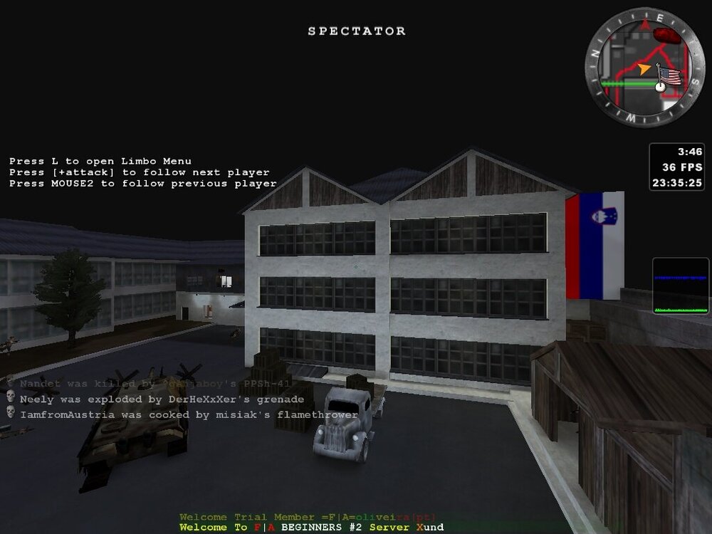

oliveirapt Posted March 11, 2023 Posted March 11, 2023 this happen on beg2 when i enter after exec my config my fps back to normal with a bit dropping i go playing on nq exec my confg and noting chance my fps satys around 20/50 and my image moving slow i try to make a demo but in the demo all seems working fine any ideas Quote

Administrators daredevil Posted March 12, 2023 Administrators Posted March 12, 2023 20 hours ago, oliveirapt said: this happen on beg2 when i enter after exec my config my fps back to normal with a bit dropping i go playing on nq exec my confg and noting chance my fps satys around 20/50 and my image moving slow i try to make a demo but in the demo all seems working fine any ideas What's your standard avg FPS? Quote
oliveirapt Posted March 12, 2023 Author Posted March 12, 2023 3 hours ago, daredevil said: What's your standard avg FPS? 140 Quote
