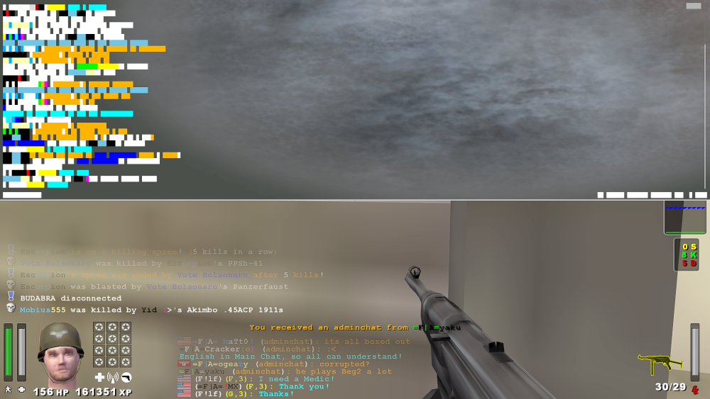

So everything was fine, playing as of 10 minutes ago. I go to check my console and it looks like this.

The blocky chat is screaming gfx card issue, maybe lack of power but that could just be a coincidence.

The block chat, yeah idk, I did just install a new driver for my 1080 yesterday, but again was working all fine up until I did the "timescale 1000" command.

It seems odd that the text copied from the text-buffer to the playing-screen (+ flags) shows okay, but the text copied to the console-screen gets corrupted into simple blocks.  It is almost as if the text colors are being treated as background colors, but they don't really match. :hmm
Perhaps you guys should report this issue to the ETLegacy development team.

vid_restart fixes it everytime for me
ET_legacy glitch nothing to do with config as i run stock ETlegacy config. If not running ETlegacy its the server side config thats been updated.
