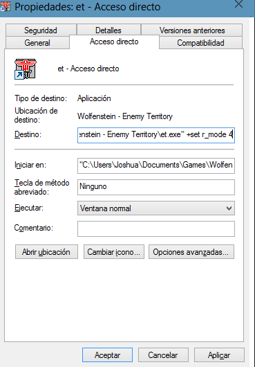

3. Your have an unsupported resolution size in your cfg. Change it in your .cfg file or in your direct acces adding this  "+set r_mode 4" just like in the pic.
If nothing works., can you please add a screenshot with the error?
