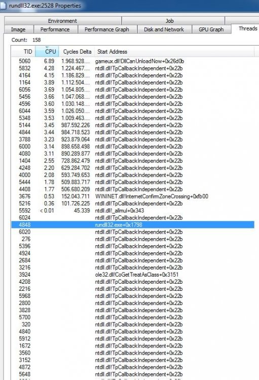

I can't speak for Masa, but I've been having the same issue. I dont play much other games besides ET, but ET is the only program I have issues with. No clue how usefull the attached screenshot is.
win7 64 bit

rundll32.exe is a windows process so points to an issue with windows rather than ET.
In windows 7 if you run taskman when you try to run ET and rundll32 starts and go to view-->select columns and click command line from the list it should tell you which process has started that specific rundll32.exe.

I tried that but it has no path

Oh i just had a brain fart and i think i have had issues in the past with games when using windows 7 as it has that games shite on it if i remember right.
Go start-->all programs-->games-->games explorer...click options and tell it not to check online for updates and uncheck the 2 boxes about collecting info for games.
Let me know, failign that i'll proceed to install 7 on a VM and try to replicate your issue.
