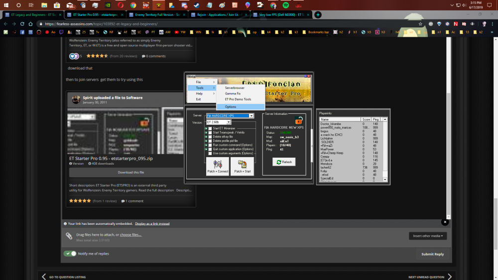

*Kiba* Posted June 17, 2019 Posted June 17, 2019 get them to try this download that then to join servers get them to try using this to add servers and what not to et starter pro see if that works i had problems with getting et to work on my brothers pc and this was the only way he could play at the time may or may not work it's up to you to try it out Quote
