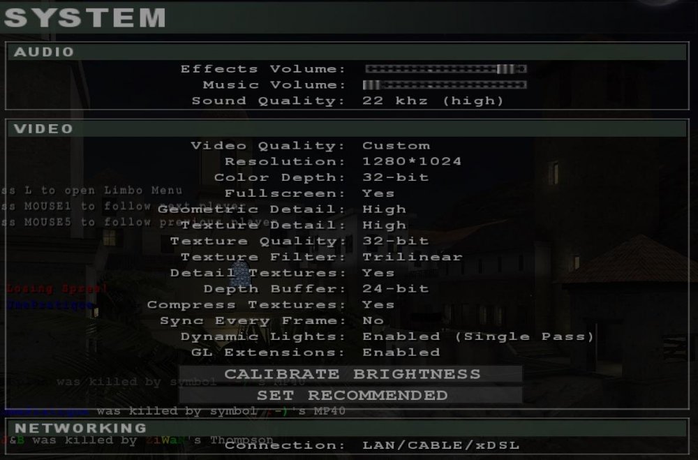

im playing on F|A Recruitment server. My FPS is locked on 29/30 and I really don't know what to do...
I tried primitives 0, 1, 2 nothing, com_maxfps also not works, hunkmegs zonemegs too. My resolution is 1920x1280 but in game is 1280x1020 like that, when i set it up to my res OpenGL is crashing. Tried in vid settings to go from fastest to high and no reason (once i had 125 FPS locked but i didnt see anything on my screen everything was blured, but next day i started up ET it comes back to 30FPS) Have anyone any solution??? Please help meh : /
My system
Intel i7 7700HQ 2.8Ghz
RAM 8GB
Nvidia Gforce GTX 1050
win 10
and its Dell Inspiron 15 5577 (link to properties : https://www.euro.com.pl/laptopy-i-netbooki/dell-inspiron-15-5577-15-6-intel-core-i7-7700hq-8gb-ram-1tb-128gb-dysk-gtx1050-grafika-win10.bhtml)
Well, with that setup, Primitives should be 2, ,r_mode would be -1
These are my R Settings and CL Settings. Some of them are probably useless, but see if you spot any differences

Also don’t forget after you connect to do a
/vid_restart
as well
Vertical sync OFF.
  • Solution
Try lauching your game from different graphics card, for me Intel is the best for ET, but if you're lagging on Intel try Nvidia etc. In both cards settings make sure vertical sync is off - when it's on it causes fps locked to 60 for me, it might be similar in your case. Also if playing with Nvidia, disable threaded optimization for ET. Consider upgrading/downgrading graphics driver if above doesn't help.
cvar_restart;exec etconfig;vid_restart
You can make a et.exe shortcut and edit the properties it will overwrite any config if connecting directly to the server

How to use this configs?
In game settings also can make difference?
I have setted up right that

This is how mine looks Toolwiz20191-14-16-54-54.thumb.jpg.8540ef1e70ecdb15c420c2b82ec5e2de.jpgToolwiz20191-14-16-54-54.thumb.jpg.8540ef1e70ecdb15c420c2b82ec5e2de.jpg
