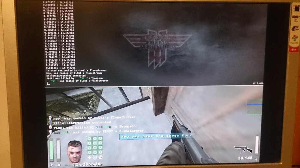

Hey. There's a mess in my console (check the picture). When I move the mouse then it appears like million of times.
Can somebody please explain what that is?
It's part of a config that one player made for me.
Is that allowed? Is that considered a cheat?
The player told me it was something to just 'correct the mini-moves or my mouse' or sth like that. Thx for the answer

Can u just post the config here, didnt really see stuffs like that yet, so wonder what cmd actually does that.
Nvm, reminded its for showing ratio between mouse movement and sensitivity.
cl_showmouserate ETMain Client Spams console with with how fast you move the mouse in ratio to sensitivity setting.
Useless stuffs to have it enabled so just write in console /cl_showmouserate 0
First part show's the movement u have done and second part shows the sensitivity u have.

@GwS BadBoy , @Aniky was Very Right.  :D  Shown below is part of your config file:
The "seta in_mouse "1" "    // Toggles support for mouse (according to antman's site and is in the default cfg from installation)
I will just copy your // Mouseettings to here and add the antman //comments  (mine in //green)
// does anybody know why the first 5 cvars might be anything other than 0 or 1 ?
seta in_Mouse                "1"            // Toggles support for mouse
seta cl_showmouserate  "1"            // Toggles smooth mouse                              // "0" is what you want here
seta cl_freelook               "2"           // Toggles mouse to Look Around                 // 0 or 1 ... perhaps it is only tested for 0
seta cl_mouseAccel         "0"           // Toggles mouse acceleration
seta m_filter                     "3"           // Toggles smooth mouse                              //  0 or 1 ... searching for 2,3 found nothing                                                                                                                                                                   // bitwise, a 3 might be detected as a 1
seta m_yaw                     "0.0165"   // Sets horizontal speed of mouse when in freelook
seta m_pitch                   "0.015"     // Sets vertical speed of mouse when in freelo
