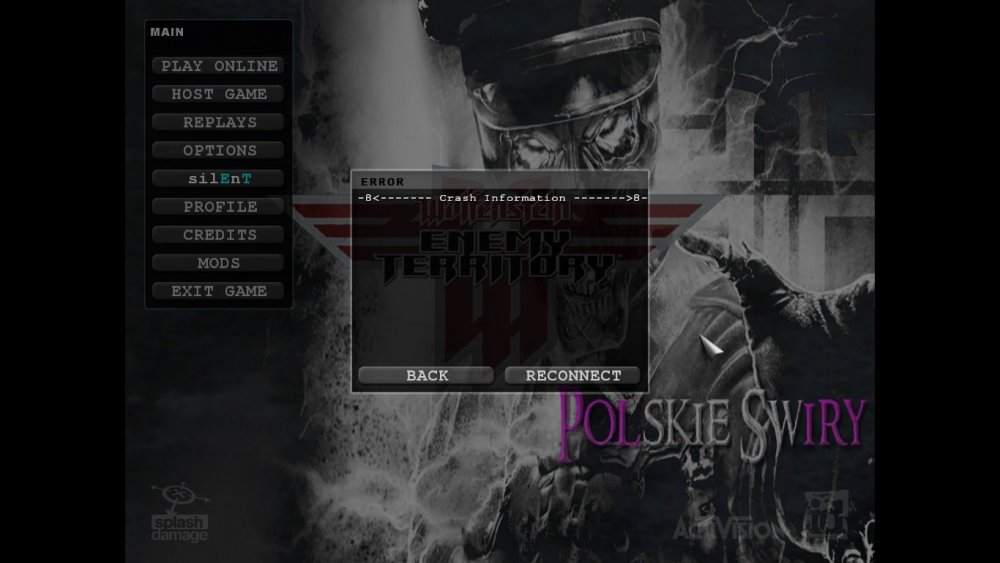

Johnwick Posted January 7, 2020 Posted January 7, 2020 (edited) Okay i have same problem and for me /vid_restart didnt help,only if the map is over ,loaded new map then i can start type again.Made some videos also Edited February 4, 2020 by RedBaird deleted 2nd video 1 1 Quote

Snuffs99 Posted January 7, 2020 Posted January 7, 2020 (edited) I don't have this issue on FA NQ1 server running 1.2.9_6 BUT i do have it on another NQ server i play running NQ 1.2.9_6 where my game crashes as soon as i press either T, Y or esc. I was thinking it was because FA uses a windows NQ install and the other server i play uses Linux but if some are having the same issues on FA NQ server then that theory goes out the window. I'm yet to find a fix or cause as the really odd thing is it doesn't happen on all maps and nor does it happen on the same maps all the time, i can be playing Goldrush for instance and pressing T or Y to talk or even using esc will simply crash ET with no info other than its crashed (like JohnWicks image above) and yet other times i could be playing Goldrush and can press T Y and esc without any crash. Like i say i dont have the issue on FA's server and my Windows/linux argument made sense until i read this thread. lol I'm going to try some things within windows as this is seeming more like a windows 10 issue, i'm currently on windows 10 pro build 1909 so it could well be a simple compat issue, i'll try running ET in various compat modes and see if i still have the problem. EDIT*** yeah tried all compat modes from 95 up and running as admin but still same issue If anyone does happen to find a fix then like others i'll be greatful, must also add that like JohnWick this issue is a few months old for me too, a clean widnows install and ET install since have made no difference. My current ET install uses 1440p Resolution on a Windows 10 pro 1909 x64 system using more than enought hunkmegs etc (tried changing that and few other setting too just to see, dont help)**EDIT Edited January 7, 2020 by Snuffs99 1 1 Quote

Johnwick Posted January 7, 2020 Posted January 7, 2020 1 hour ago, CheepHeep said: @Johnwick You do vid_restart after you join a server bud. I don't know what the fix is and I know many have the same issue - this is the only thing that kinda works right now until something more permanent comes along. Yes ,tryed now this way also ,now did not crash anymore but weird resolution after vid_restart,maybe really instll Legacy client ,what for is it anyway ? 😁 1 Quote
