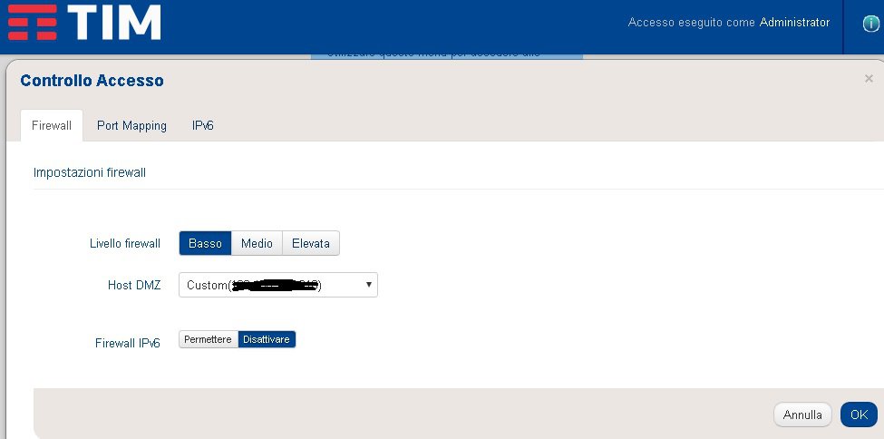

after reading, I came up with an idea, my Modem has an internal firewall against 3 levels of protection, maybe in the article I read this was intended as NAT levels, then I checked and
I attach the photo of the settings that I have modified
before it was set to the maximum
I've put it to a minimum now

  the computer I use to play ET, of the 4 I connected at home, and in the modem firewall setting I created a DMZ wasting the ip address of my LAN network card
I hope I have not done the wrong things, the only doubt I have is this

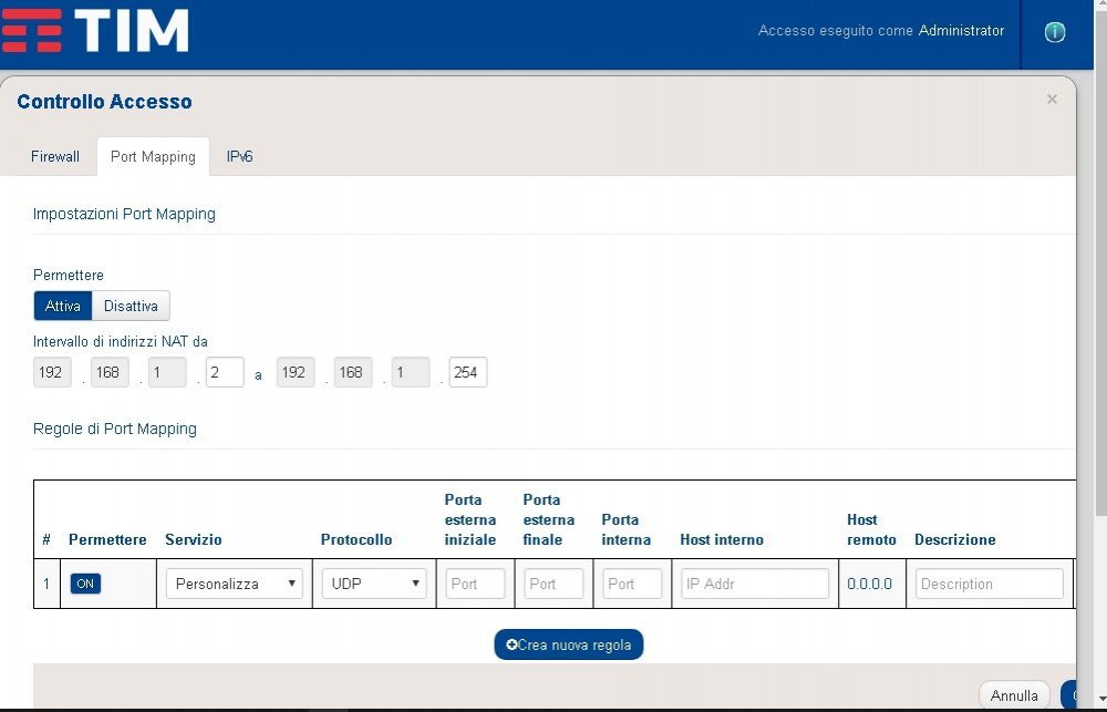

the UDP port that the client side uses is 27960, if I enter a server example jay3 or jay1? or et la to client has a different port?
and all I've done is stupid or correct?
can anyone of mine explain what I have to put here?
1995816494_routerfirewallsettingportmapping.thumb.jpg.c346a66d88fe94b7ae7f894b95f0fb8e.jpg

Never expose ports and such if not required. It's security risk. Router opens the port on demand. Do you have issue connecting to server? No then you don't need port forwarding.
