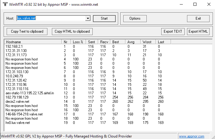

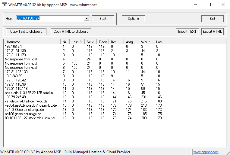

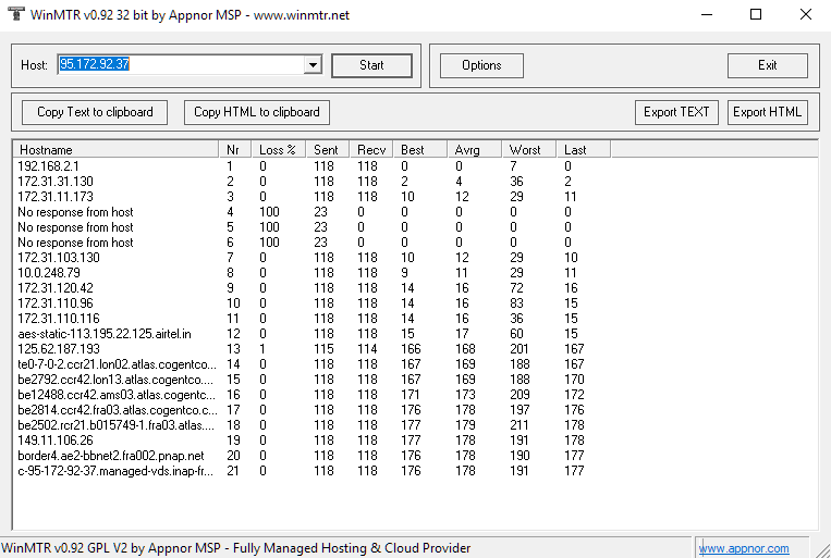

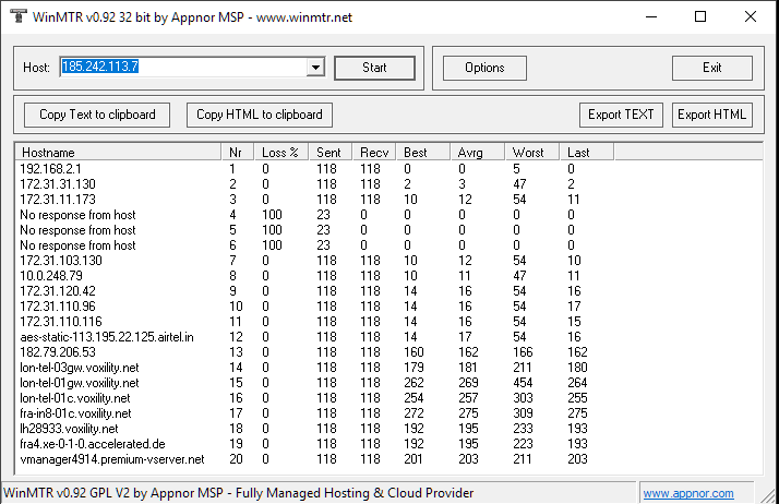

edit: here is the result with a tenda router, (i forgot name :P )
|                                      WinMTR statistics                                   |
|                       Host              -   %  | Sent | Recv | Best | Avrg | Wrst | Last |
|                             192.168.2.1 -    0 |  107 |  107 |    0 |    0 |    1 |    0 |
|                           172.xx.xx.wyz -    0 |  107 |  107 |    2 |    2 |   28 |    3 |
|                           172.xx.ab.cde -    0 |  107 |  107 |   10 |   10 |   18 |   11 |
|                   No response from host -  100 |   22 |    0 |    0 |    0 |    0 |    0 |
|                          172.31.103.130 -    0 |  107 |  107 |   10 |   10 |   17 |   10 |
|                             10.0.248.79 -    0 |  107 |  107 |    9 |   10 |   13 |   10 |
|                           172.31.120.42 -    0 |  107 |  107 |   14 |   15 |   26 |   15 |
|                           172.31.110.96 -    0 |  107 |  107 |   14 |   15 |   31 |   14 |
|                          172.31.110.116 -    0 |  107 |  107 |   14 |   15 |   20 |   15 |
|     aes-static-113.195.22.125.airtel.in -    0 |  107 |  107 |   14 |   15 |   35 |   15 |
|                           182.79.245.18 -    0 |  107 |  107 |  144 |  152 |  241 |  146 |
|                    decix2-gw.hetzner.de -    0 |  107 |  107 |  258 |  261 |  328 |  258 |
|                 core21.fsn1.hetzner.com -    0 |  107 |  107 |  265 |  280 |  418 |  312 |
|              ex9k2.dc3.fsn1.hetzner.com -    0 |  107 |  107 |  272 |  273 |  318 |  273 |
|static.170.72.63.178.clients.your-server.de -    0 |  107 |  107 |  266 |  267 |  274 |  267 |
|________________________________________________|______|______|______|______|______|______|
   WinMTR v0.92 GPL V2 by Appnor MSP - Fully Managed Hosting & Cloud Provider
Edited by Carbonautics

Here's a winmtr result to US INS server, which is normal i guess from India to US.
|                                      WinMTR statistics                                   |
|                             192.168.1.1 -    0 |  107 |  107 |    0 |   21 | 2241 |    0 |
|                                              IP -   96 |   23 |    1 |    7 |    7 |    7 |    7 |
|                             10.0.248.79 -    1 |  104 |  103 |    0 |   30 | 1616 |   10 |
|                             10.0.248.79 -   96 |   23 |    1 |   17 |   17 |   17 |   17 |
|                          172.31.110.116 -    1 |  104 |  103 |    0 |   35 | 1617 |   15 |
|                          172.31.110.116 -    0 |  107 |  107 |   15 |   41 | 2238 |   15 |
|     aes-static-113.195.22.125.airtel.in -    0 |  107 |  107 |   24 |  255 | 2239 |  235 |
|                          182.79.152.231 -    0 |  107 |  107 |  244 |  306 | 2244 |  286 |
|         nyiix.gi3-6.cr1.nyc1.choopa.net -    0 |  107 |  107 |  268 |  295 | 2242 |  268 |
|                vl41-br1.pnj1.choopa.net -    0 |  107 |  107 |  268 |  289 | 2246 |  269 |
|ethernet1-2-1-c1-16-b2-1.pnj1.choopa.net -    0 |  109 |  109 |  254 |  269 | 1188 |  275 |
|               108-61-21-93.constant.com -    0 |  109 |  109 |  255 |  269 | 1189 |  275 |
Can u run winMTR against the another Euro server and post here for comparison? I need to see how u are getting 140 on other Euro servers and on our servers 250 appx. Then I will send both winMTR to host and ask them to look into it an see if they can improve their networking performance.
If not, I will whine on other public forums and that would get their attention. That's how they work sadly.
Do you need Germany server or any server from the  Europe, like London or Spain?
Also, its not 'just' our servers, most have normal ping, some have abnormal, its not that its high only on FA, if I have interpreted it that way then im srry :P
Server1: Luxemborg Valve server#1
Server2: [EU]EMpush Insurgency server somewhere in germany
Server3: some clan Insurgency server from Germany as well
Server4: some other clan Insurgency server from germany
