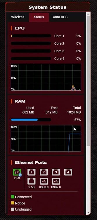

Your ping fluctuates wildly (called "jitter"). This explains your connection problems on the game servers.
To rule out that your home network is at fault, ping your router. You can find out your router's IP address by typing the command ipconfig into the command prompt. Your router's IP address is listed under 'default gateway'.
If you use a wired connection, your ping should be about 1 to 5 msec. If you use a wireless connection to your router (WiFi), it should be at least under 20 msec. Check for any sudden ping spikes.
If your home network shows no abnormalities, contact your ISP asap and explain the issue to them: high jitter that makes using real-time applications over the internet impossible. If your home network is not at fault, it is up to them to fix the issue.

He pinged google.com 24 times and his ping fluctuated between 10 msec and 328 msec, with other highs of 94, 62 and 55 msec in between. Unless he fully utilised the bandwidth of his connection while doing the ping tests (=> buffer bloat), this is insane jitter and if he has jitter like this regularly, it makes playing online games basically impossible.
For good measure you could ping more targets, do it at different times of day, increase the sample size (like ping a thousand times with the parameter -n 1000), run traceroutes or (preferrably) pathpings to find out at what hop exactly the issues of ping spikes emerge, but personally I wouldn't bother. If the home network turns out to be running without abnormalities (see above), I'd just contact the ISP. It's an issue on their side, not yours.

45 minutes ago, Tukkonen said:
I think the issue is FPS related. Today i asked this cg_drawfps 1 and the fps was changing between 10 to 45 or so, when people were in the screen. Also heard that recruiting server doesen't lag (jaymod), but silent mod does this.
If fps issue, sounds like r_primitives is set wrong. If you have amd gpu, set it to 2, if nvidia then 0 is ok.
So also on fps these affect much:
seta cg_showblood "1" <-- set 0 to disable
seta cg_shadows "1" <-- set 0
seta r_flares "1" <-- set 0
Edited by RendeL
On 12/7/2023 at 10:23 AM, RendeL said:
seta snaps "20" <-- change to 40
This is server driven. Only our ETL server runs on 40 snaps.
@HotChip - Check your Nvidia settings. Nvidia has better support on OpenGL drivers vs AMD. Even AMD has improved their support recently. Try below settings and let us know how it goes. I play from 2060 Nvidia GPU. Your 2070, should give you stable 125 FPS without any issue.
He can kiss his fiber good buy then.. cos that's crazy high jitter. BW consumption adds to jitter but he can have modem, router, signal strength, etc. issues. I barely touch more then 50% CPU in my router with 50+ devices connected.
