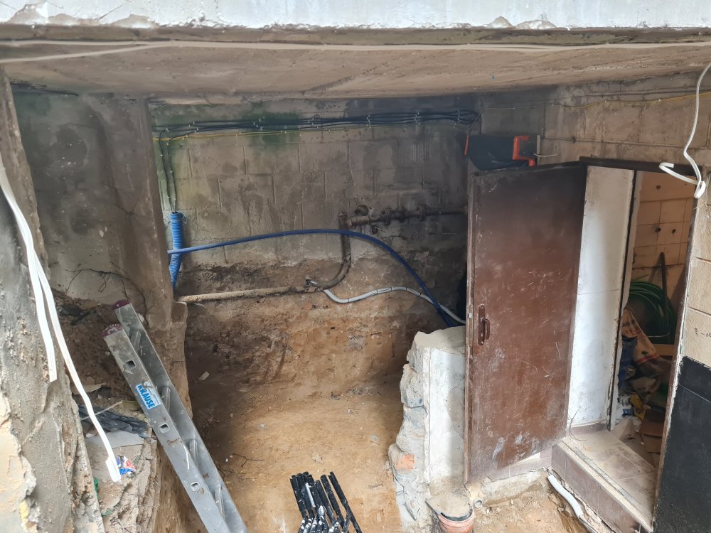

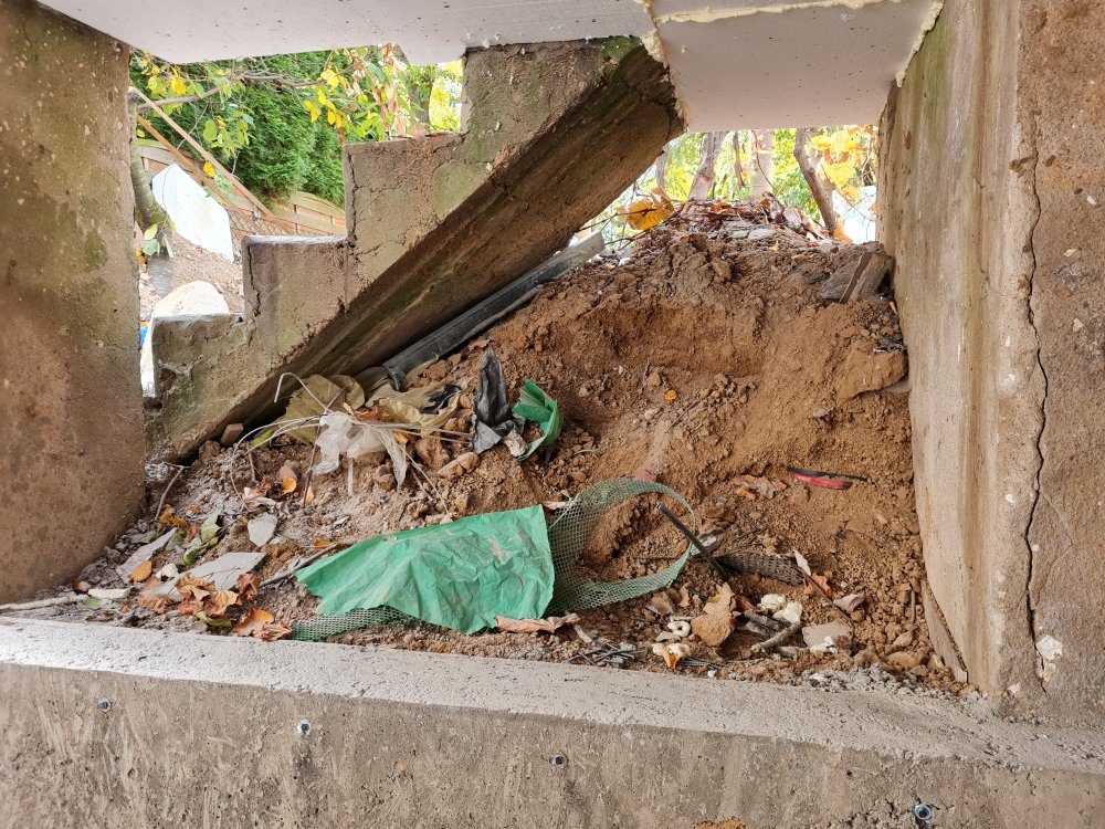

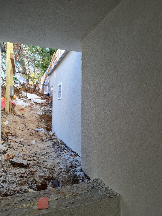

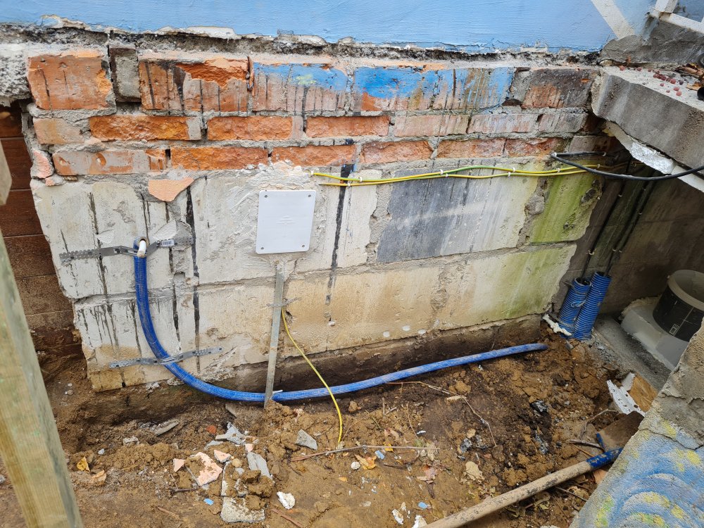

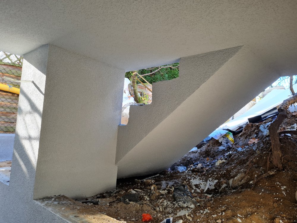

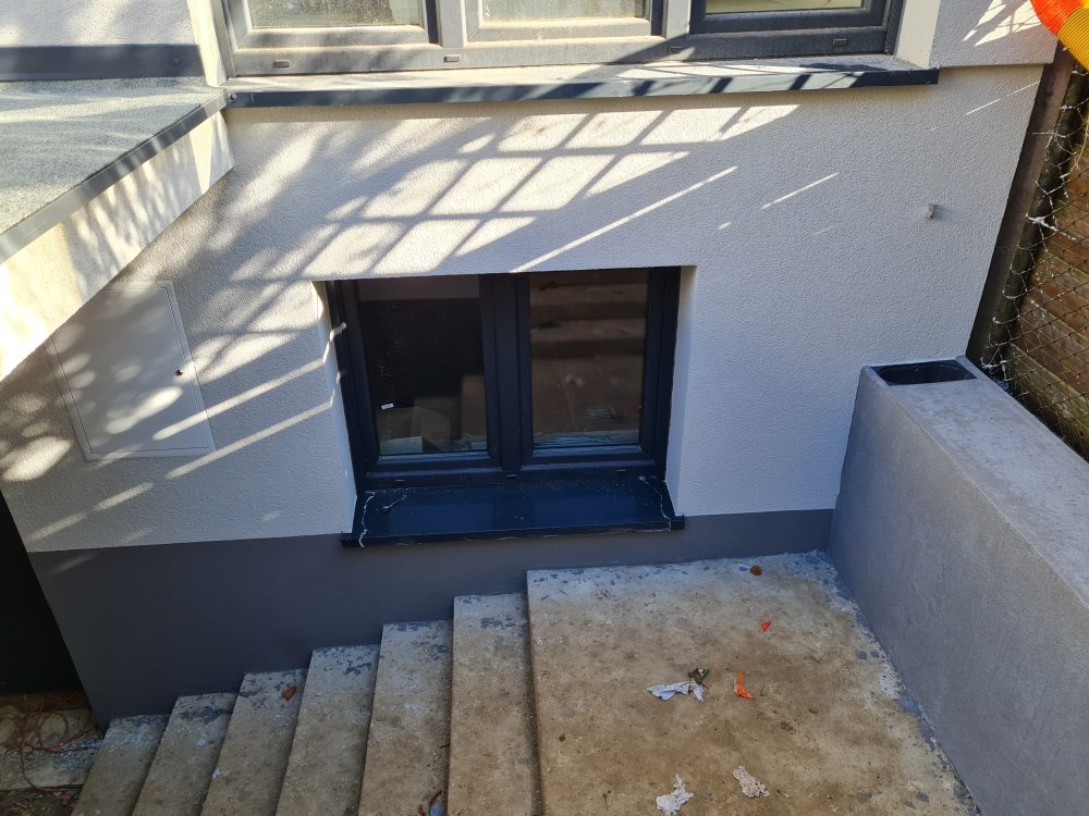

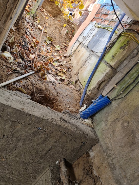

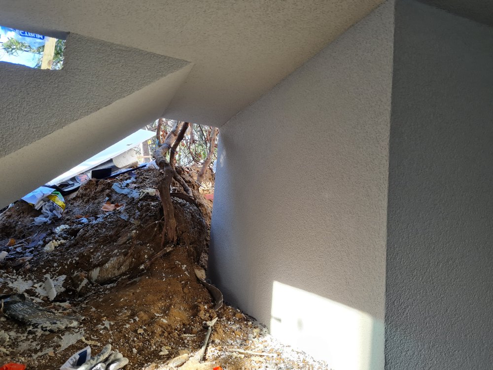

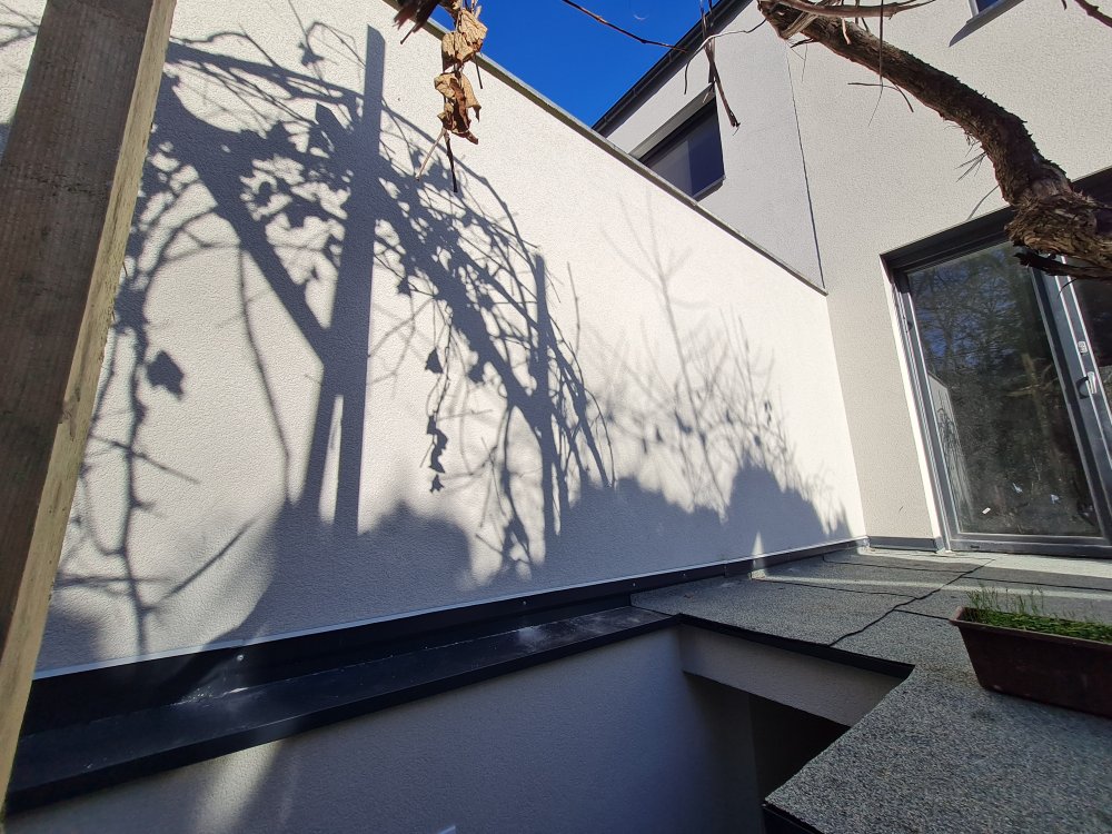

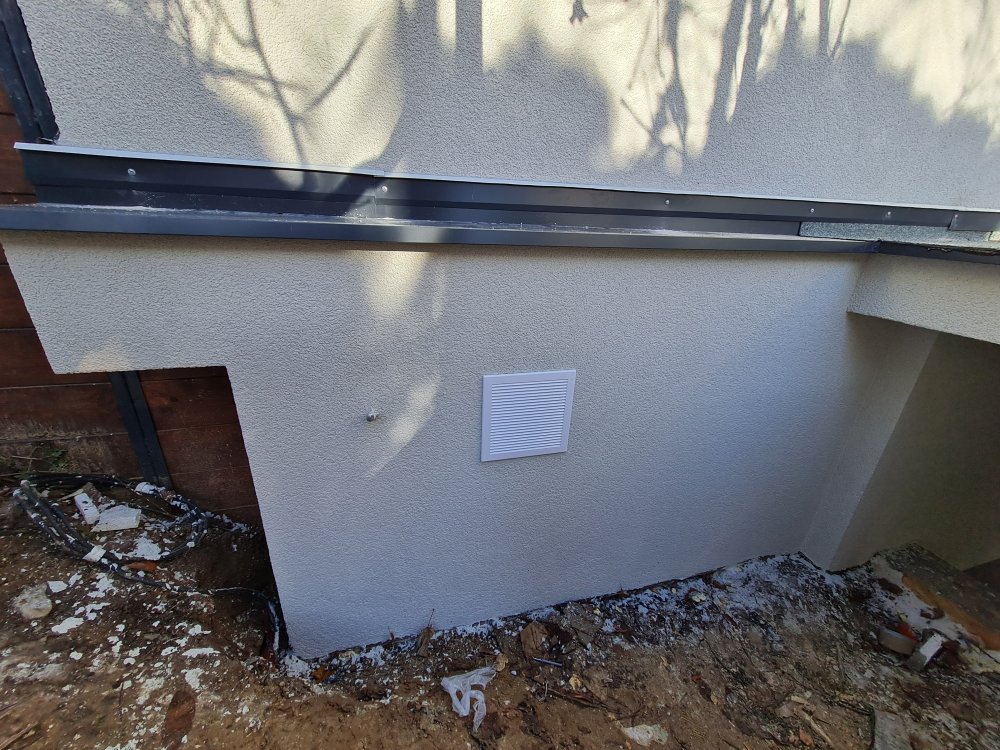

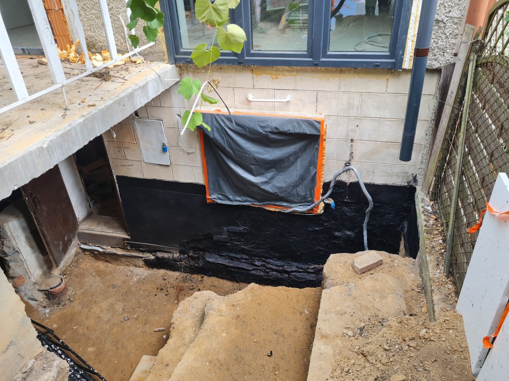

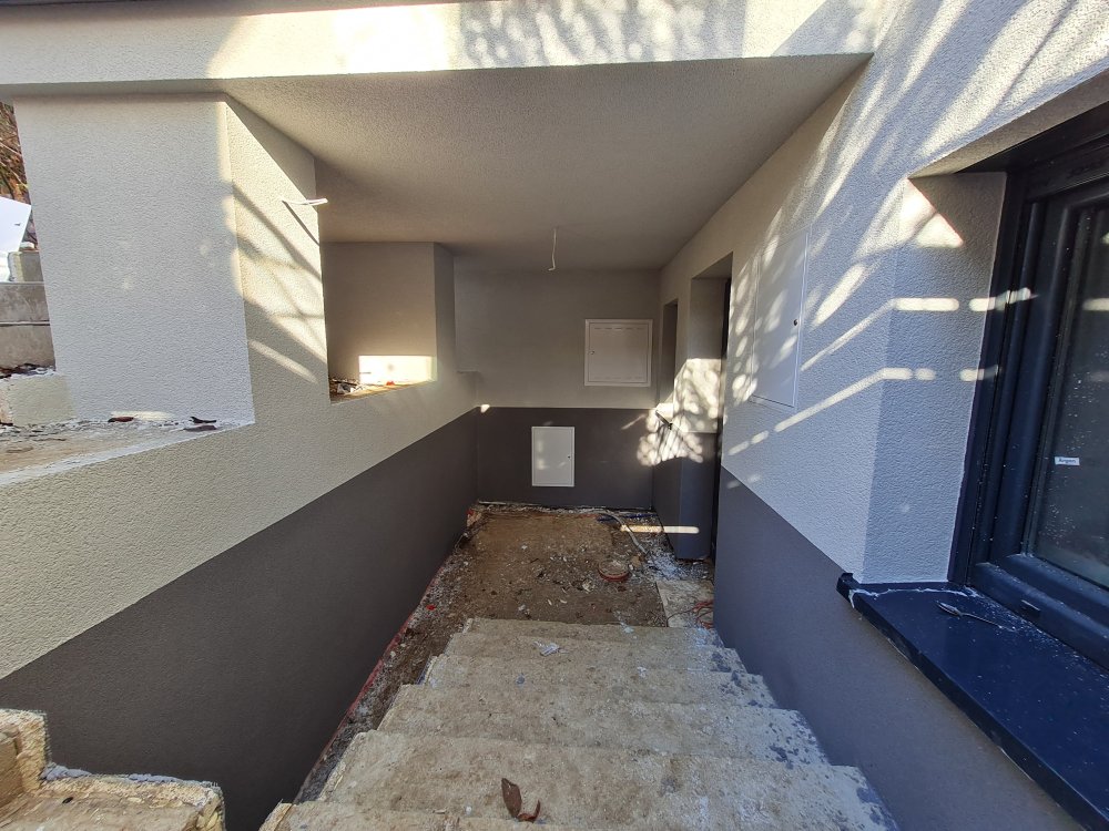

Popular Post yaku Posted November 2, 2022 Author Popular Post Posted November 2, 2022 For me the most satisfying before/after effect in a long time. @Sisje, you may like it! 9 2 Quote

captnconcrete Posted January 26, 2023 Posted January 26, 2023 me an you could make some$$$$ working together. its not a job if u have fun and love it.loved the fireplace remodel. and trimin them walls out looked like fun!!! those steps looked interestingf what product did u use to recoat em? 1 Quote
yaku Posted January 26, 2023 Author Posted January 26, 2023 11 minutes ago, captnconcrete said: me an you could make some$$$$ working together. its not a job if u have fun and love it We can talk about making some business, haha ? 11 minutes ago, captnconcrete said: those steps looked interestingf what product did u use to recoat em? The stairs are covered with 2 cm thick polystyrene to straighten them with something light. Then the polystyrene is lightly sanded and covered with cement glue with a reinforcing mesh, primed and put on silicone plaster with pebbles of different gradation (here 1.5 mm), which can be bought here in buckets like that: For some technical terms I used translator so I hope it's understandable ? 2 Quote
captnconcrete Posted January 27, 2023 Posted January 27, 2023 20 hours ago, yaku said: We can talk about making some business, haha ? The stairs are covered with 2 cm thick polystyrene to straighten them with something light. Then the polystyrene is lightly sanded and covered with cement glue with a reinforcing mesh, primed and put on silicone plaster with pebbles of different gradation (here 1.5 mm), which can be bought here in buckets like that: For some technical terms I used translator so I hope it's understandable ? yes i understood it .lol thanks. ive done sum like that also.. u ever used drazel. amazing stuff. 1 Quote
