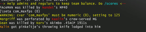

anyone know why i keep getting this its only when i use my mouse
this warning appears when you set a wrong string in your cvar.
In this case (0) for /com_maxfps
I have tested myself :
The cvar is not accepted and not set after the error.
I am sure that you have bound "/seta com_maxfps (0)" in a key, used by the mouse.
Please check your binds in your configs / try to find with key is bound - you certainly have bound mouse key by error.

He will also get that error message if the bind is missing a semicolon between declarations like this: "...;com_maxFPS 71 cg_crosshairSize 32;..."
The engine is trying to parse "71 cg_crosshairSize 32", for example, as a number and can't do it safely.
ET 2.60b fails quietly but ET Legacy throws that error message to let you know you failed to set com_maxFPS and it has reverted to a safe default.

I have forgoten to mention a parse error!
Anyway, in this case @bigbro you could share your cfg

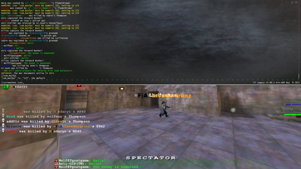

Check these lines :
bind mouse1 "+attack;com_maxfps 100"
bind mouse2 "+moveup;com_maxfps 125"
set com_maxFPS 125
Please remove com_maxfps from mouse1 and mouse 2
bind mouse1 "+attack"
bind mouse2 "+moveup"
Add double quotes here
set com_maxFPS "125"

thanks thats worked a treat
