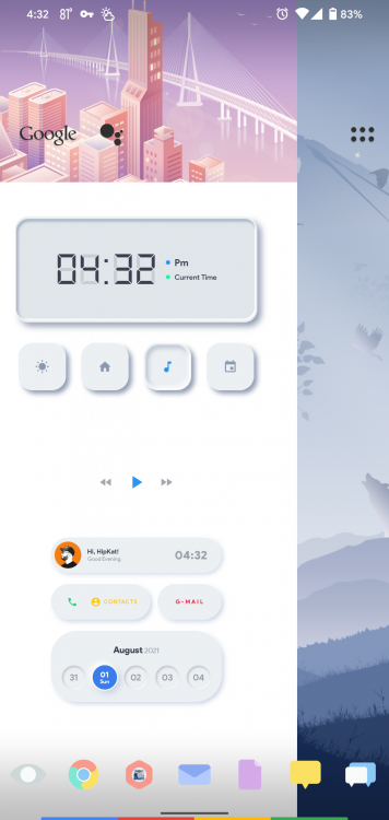

I just wonder if some of the Android apps I'm going to be able to run include apps for theming like kwlp. If I can make my Windows desktop look like my phone desktop, that would be the bomb.

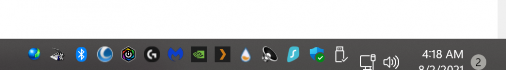

One major bug i have is system processes by the clock you have to allow 1 by 1 in win 11 settings otherwise they go into the overflow where you have to click the tick to show what else is running
Under windows 10 you can simply turn on the show all option
I like to see what is running at all times so the idea of adding each program 1 by 1 is going to get annoying
Edited by Snuffs99
You and I are on the same page there because I find that also very annoying. Plus and I'm not there to take a screenshot but there's a graphic glitch in the systray where the clock and calendar are about half a line lower and partially obscured under the bottom of the screen

I figured out my systray glitch - I did a regedit edit to make the taskbar buttons smaller
