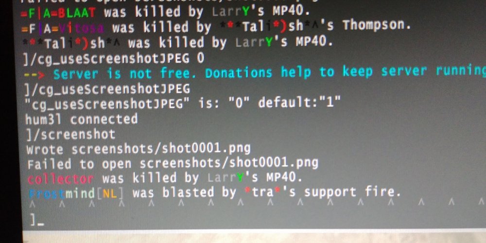

Dunno what's wrong but /screenshot doesn't work at all
even after fresh install still got same problem ?
i think i'll go back to 2.76
You need to have set cg_useScreenshotJPEG "0" for ss to even work and also define F11 from options to ss. For some reason the key is resetted for me.
Also /screenshotjpeg doesn't work at all. And my hud doesn't load itself, but have to load it manually.
yes I have bind F11 set for screenshot since forever
still doesn't work:

but I've just installed 2.76 and screenshot works just like it should, i'm so confused ?
I also use ETL 2.77.1
It works fine so i suggest to upgrade.
Gengis
its the antivirus , i had problem to create condumps , disable it sand try
