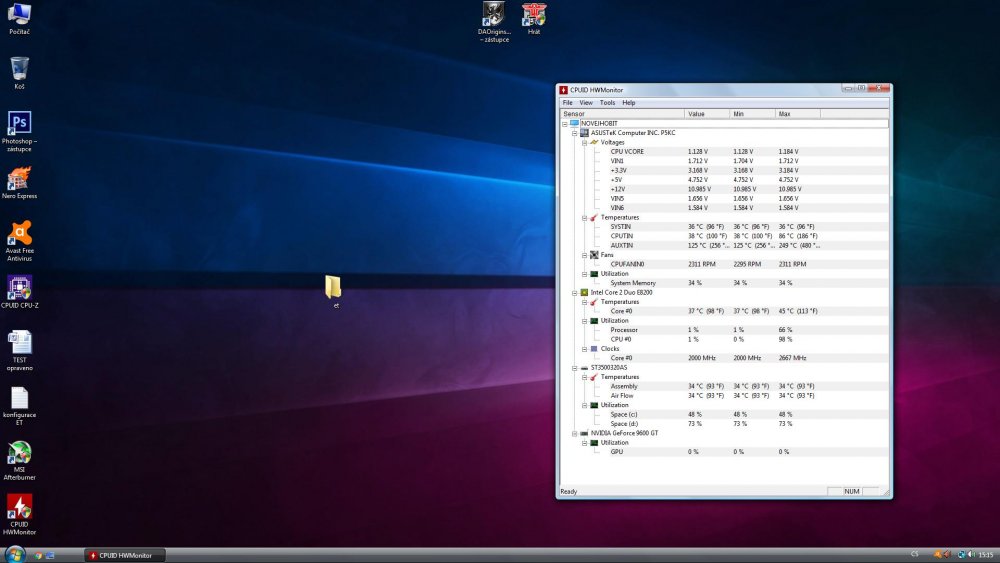

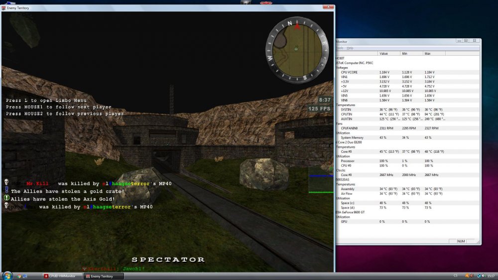

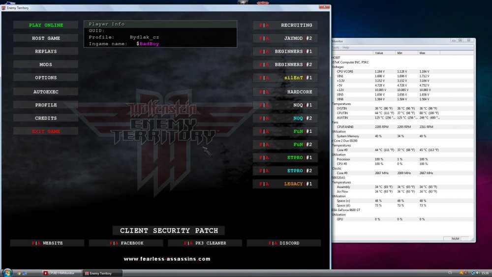

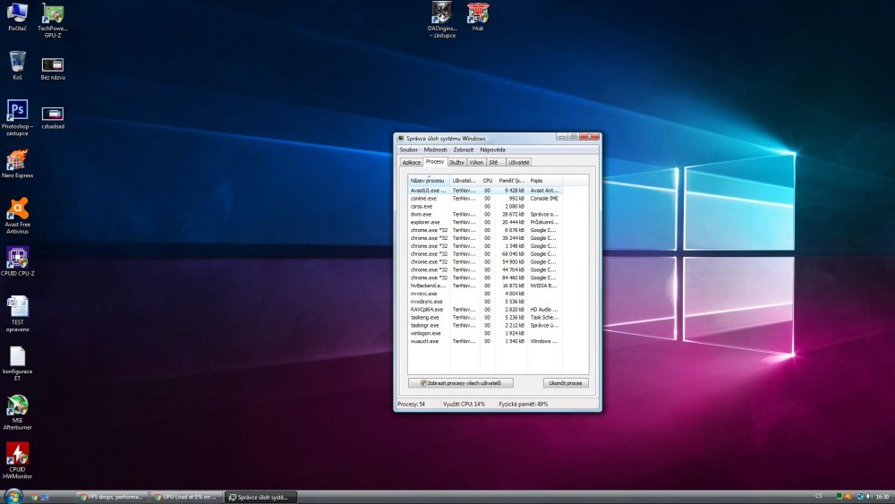

GwS BadBoy Posted January 12, 2021 Author Posted January 12, 2021 (edited) It doesn't stay 100% all the time, it's like 1-4% when nothing is running but when i switch on this forum for example or play video on youtube it automatically jumps to 80 or 100%. When ET is on it's 100% all the time. I think that the CPU-Z programe just doesn't show GPU properly, in GPU-Z it actually shows some GPU usage data. Here are the processes, hope u meant this: Edited January 12, 2021 by GwS BadBoy Quote

GwS BadBoy Posted January 12, 2021 Author Posted January 12, 2021 (edited) Yes its quite playable but my goal is to reach stable 125fps which is not happening, mby im too naive. Anyway, u damn right Gladis, Vista sux xD Okay i made some progress updating chipset and mobo drivers and so, now both cores are available and visible, CPU usage culminates between 80 - 99% with ET on, which definitely is improvement. FPS still drop but game seems to be more stable. PC also is much faster. Edited January 12, 2021 by GwS BadBoy 1 Quote

GwS BadBoy Posted January 12, 2021 Author Posted January 12, 2021 (edited) Thx for advice, well right now i got: Asus P5KC mobo, 2x2GB DDR3 RAM 1333 MHz (cpu-z shows dram freq 666,7 MHz, fk me if i know what that means) Intel Core2 Duo E8200 2.66 GHz (please help me here coz CPU-Z often shows its running 2000 MHz - i think its downclocking (?) because not so much Hz needed at the moment but i wanted to switch it off so it stays 2.66 all the time but it seems impossible on Vista, i have all switched to performance) Nvidia 9600GT 512MB 256bit win Vista 64bit 400W source Edited January 12, 2021 by GwS BadBoy 1 Quote
