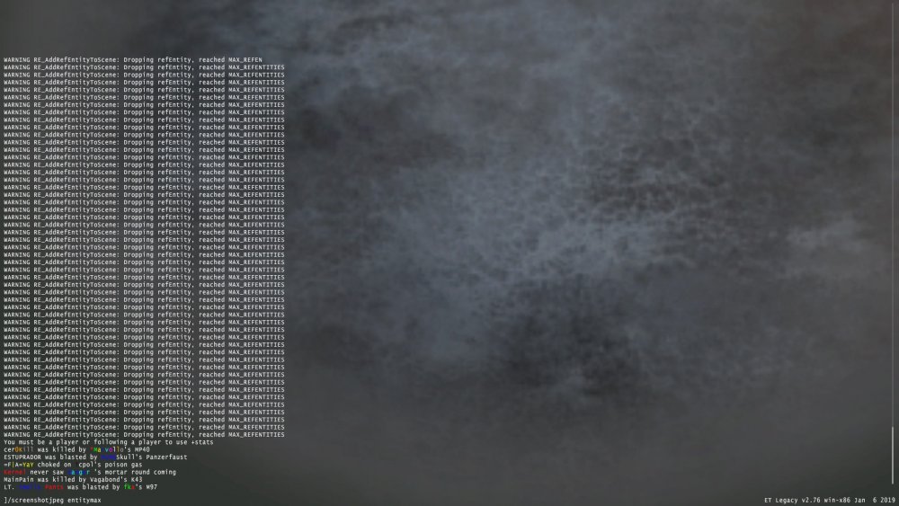

Keep getting this issue on jay1 that spams my console for few seconds and drops my fps from 240 down to 100-120 range. Mostly occurs on FA Bremen but has happened on other maps with high player counts.
So far I havent seen this issue on any other server.
ETLegacy client, have not tested on ET vanilla client.
The same thing is happening on vanilla ET there just isn't an error message in console. The FPS drops are correlated with but not directly caused by this error.

I see something today in my console about max refentities, like more than 15 lines of error msg.  that was not exactly the same but the end yes
I was not playing when that happend so I don't see changing in the game, but there were lot of ppls on the server a this moment. It was either on north pole or on Fueldump Christmas ( I have a doubt..)
And also with EtLegacy.
I just want to tell it because that was on Beg2 which is a silent server, so not only on jaymod
I think I took a SS but I don't have...(will put a txt on f11 " doesn't work on console!!!!!") I'm really sorry for that

You can screenshot consoles by doing /screenshotjpeg <whatever you want to name it> and itll save into screenshot folder in jaymod/silent folders.
Using this allows you to name the screenshot so if Cabal being a whiny pest on the server you can do /screenshotJPEG CabalVeniceWhine
so in the folder you can see the exact SS you need for a report :) saves me a ton of time of sifting through all the SS I save.
