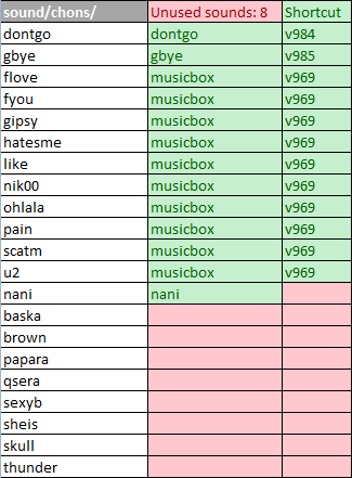

I made a excel file (just NQ for now as I don't have time for Jaymod today). I found out that there's 261 .wav files total (excluding killing spree, hit sounds, etc.), from these 261 files players can use 177 of them as 84 .wav files doesn't have vsay command from them. From these 261 .wav files, 108 aren't in voice menu. Adding these numbers up, I noticed that there's 24 .wav files that can be used with /vsay but not through voice menu (Excel file in attachment).

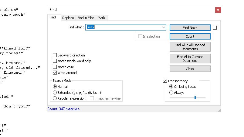

to be exact there is 347 matches for .wav sounds directly in the .voice script

@DoubleDragon Well, I'm not using excel with scripts to make these things. I... already know most of those things. Excel table is for seeing which .wav files does have /vsay command and voice menu place for them.
As you can see, almost half of the sounds in "chons" folder is unused. Also one of those used .wav files (nani) isn't in voice menu. This means that it can only be used via /vsay.
I understand what you were confused about my doings but hopefully this clarifies it :)
