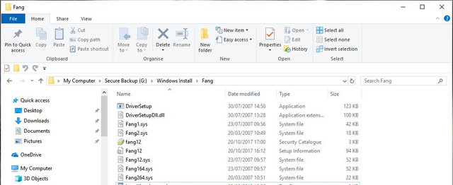

Well if your drivers are fooked dare I'm assuming this new update will fook my zboard fang, its a legacy device which windows 10 no longer support and every major update seems to block unsigned drivers and my fang stops working till i rename all the needed drivers and then i have to force windows to use unsigned drivers.....arggghh, I'll back them up now before i forget and wonder why my fang isn't working when it finally gives me the 1903 update....pain in my arse these larger updates.

Thanks for the offer of help mate but i've had to do the process a few times now with windows 10.
Soooo in a nutshell. to get my fang working with windows 10.........
Had to install zengine and then rename all the Alpham files (.inf and .sys mainly) to fang (so fang1.sys, fang2.sys, fang12.sys etc),
delete the .cat files,
install Windows Driver Kit,
add inf2cat.exe install directory,
create a new .cat file (fang12.cat in my case),
disable unsigned driver enforcement within windows

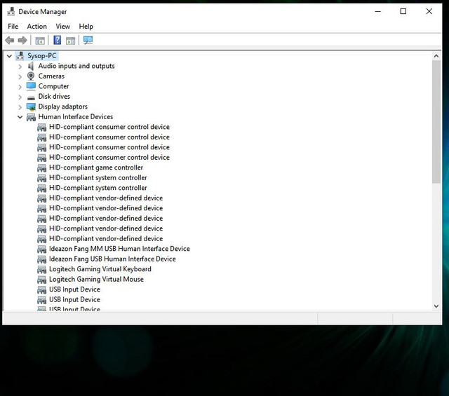

then go device manager and point windows to the driver files i'd created instead for all Ideazon USB Human Interface Devices.
Doesn't really do all the fooking about justice when its condensed into 8 simple steps, obviously way more to it than just those steps but you get the idea and gets the point across.  :)
Works great and I've got the driver(s) iv'e created saved but every large windows 10 update (creators (1803), October update (1809)and no doubt the may (1903)) up to now reverts windows back to enforcing unsigned drivers and i have to turn it all off again and once again point windows to the drivers i've created instead via device manager etc.
Probably easier to just buy a new device but i like the fang and after 16 years of playing ET with it would miss it, a lot.
My fang
Device manager
Drivers i've had to create
