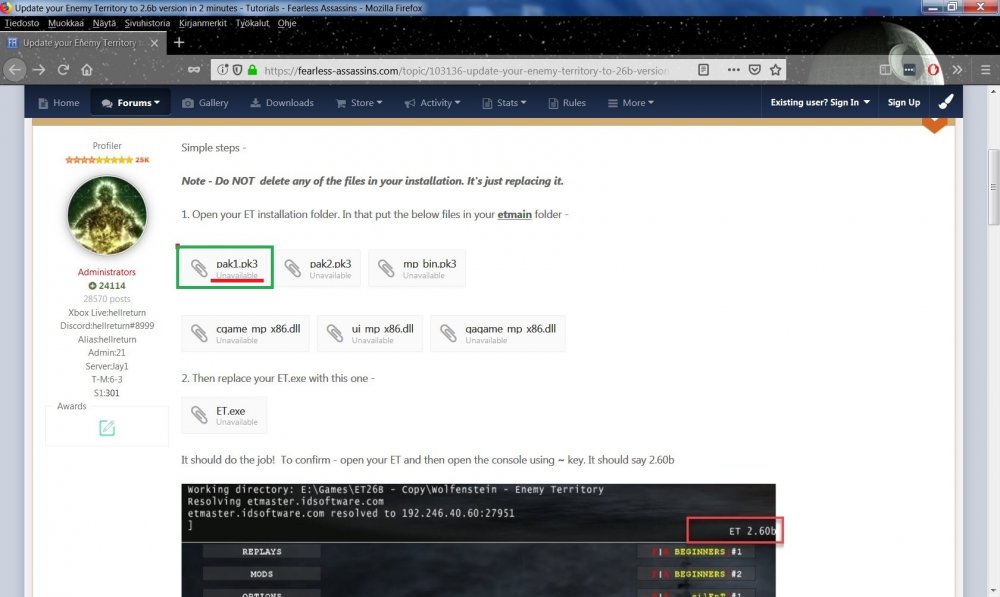

Administrators Popular Post daredevil Posted March 26, 2019 Administrators Popular Post Share Posted March 26, 2019 Simple steps - Note - Do NOT delete any of the files in your installation. It's just replacing it. 1. Open your ET installation folder. In that put the below files in your etmain folder - pak1.pk3pak2.pk3mp_bin.pk3 cgame_mp_x86.dllui_mp_x86.dllqagame_mp_x86.dll 2. Then replace your ET.exe with this one - ET.exe If you play ETPRO then use ETPRO.exe - ETPRO.exe It should do the job! To confirm - open your ET and then open the console using ~ key. It should say 2.60b 7 6 2 Quote Link to comment Share on other sites More sharing options...
captnconcrete Posted March 30, 2019 Share Posted March 30, 2019 ur missing pak 0 .pak3 me thinks. Quote Link to comment Share on other sites More sharing options...
Administrators daredevil Posted March 30, 2019 Author Administrators Share Posted March 30, 2019 1 hour ago, captnconcrete said: ur missing pak 0 .pak3 me thinks. pak0 u should have it if you install 2.55. What’s pak3? 1 Quote Link to comment Share on other sites More sharing options...
