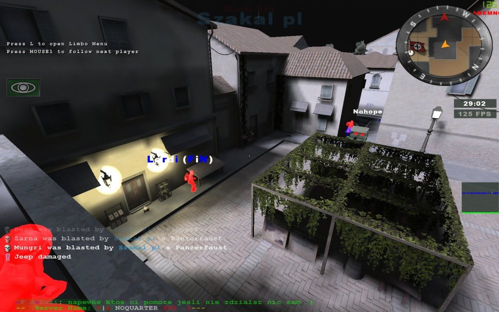

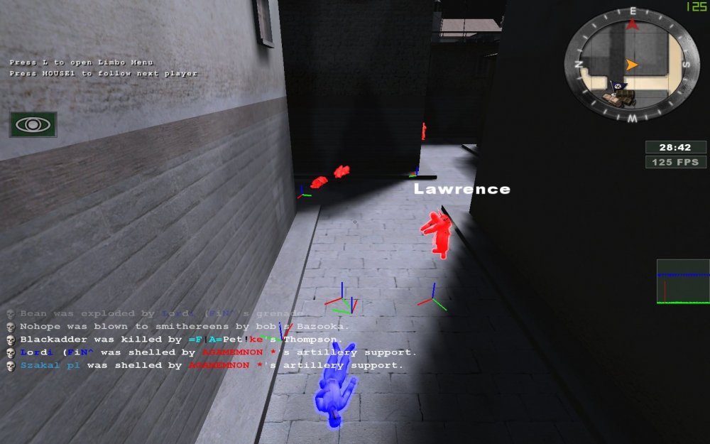

Hello i need help , i dont have sound (shoot, hs body hit others) my hitsound (ded) i dont see weapon and enemy weapon , no effects art bazooka , Maybe i need new cfg ? i use my cfg to etpro . Thanks for help
cg_draw gun not work
commands to sound didnt work

WTH are we looking at here? What's with the red and blue players?
No Quarter feature
