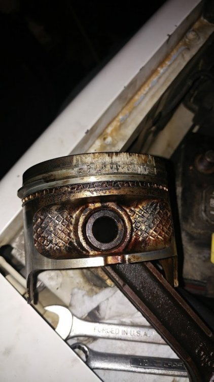

Got a Honda F22 to pull apart shortly, but the last rebuild I did (AMC 4.0) was due to this:
Thermostat failed shut in gridlock traffic, blewup the rad and seized the 2nd piston.

if u notice down there under cylinder  nice made in usa craftsman ..love it...  i grew up in a radiator shop..seen some nasty stuff.
Fuel pump overpressure?  That could cause leaky injectors and cause the crankshaft to crack under the extra torque.  That would also cause the gas in the oil.   Also would cause the overheating, which would blow the radiator and cause the pistons to seize up and fry.  Clogged fuel reg, would also clog the return or admission line and cause over pressure.  Sediment in your tank possibly?

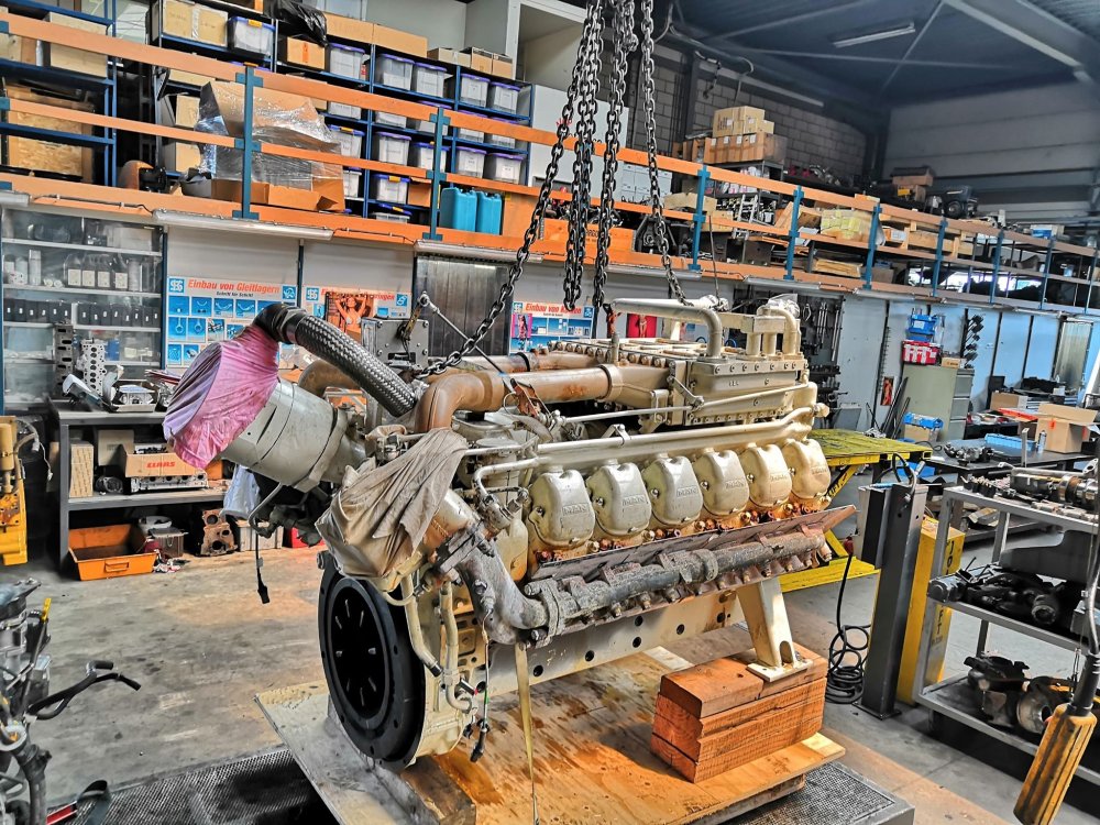

3 engines came in today 2 with a broken crankshaft xD first one is a iveco and the second one a caterpillar

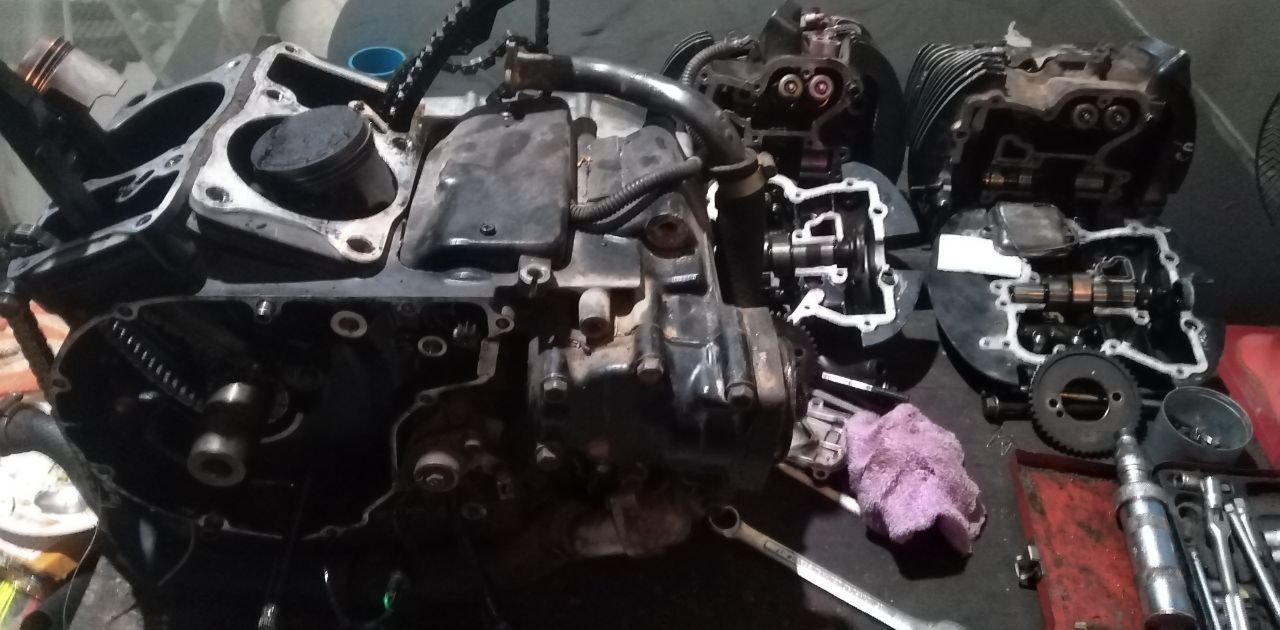

pulled this very sick engine from a Suzuki intruder today and stripped it for diagnosis
front cylinder big end of conrod gone, likely 100% there's crank damage too, cylinders weirdly enough OK but pistons and rings done, one headgasket on the front had to have been done for many hundreds of km's engine is full of soot and carbon where it shouldn't be
and starter clutch gear was wobbling around and clanking like crazy because some genius has blocked the oil gallery in the crankshaft somehow; probably by using soft metal instead of the correct puller to remove stator rotor
like 2/3k usd in parts if buying new japan oem, but I think I can do it for $800 parts with good secondhand crank, rods, cases assy and new pistons, new nings, new valves and seals and all gaskets for the owner, we will know for sure in 2026!
