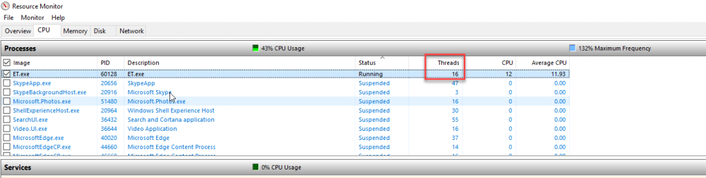

"ET is single thread"  - That's some old CPU stuff. New CPU's and OS are much smarter.. when I say new aka anything from core i series or even core 2 duo running with Windows 10. Here is the proof. Don't mix threads with CPU physical threads. CPU has cores + threads. Some just cores. Cores are like non shared hosting and threads are like shared hosting within core.
