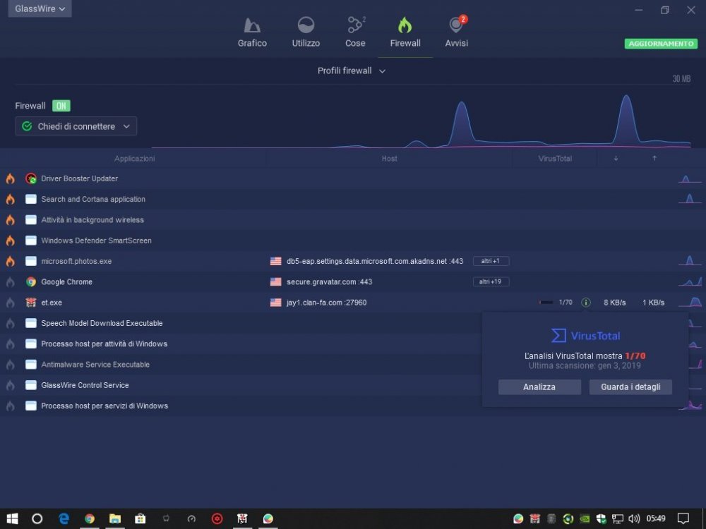

Xernicus Posted January 3, 2019 Share Posted January 3, 2019 1/70 is definitely not a sign of a virus. With a detection ratio like that, that's a false positive. For that matter, I've never even heard of Cylance, which is the AV that detected it. Are you using the Client Security Patch? That has come up as flagged once or twice. Quote Link to comment Share on other sites More sharing options...

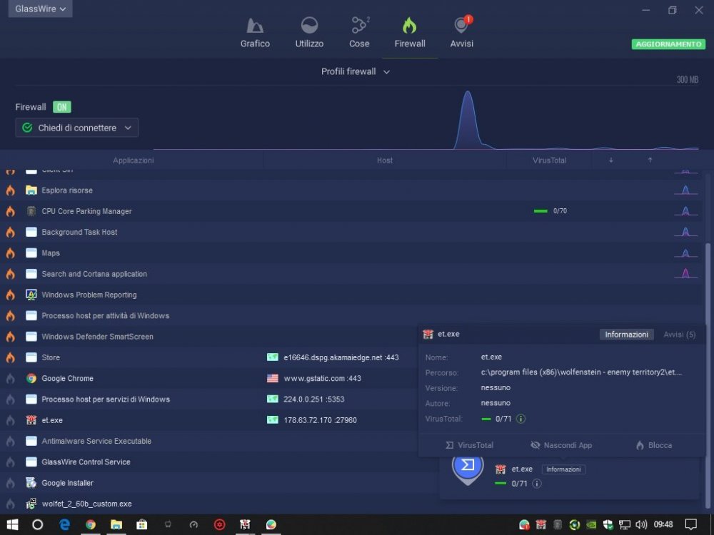

Lenovo Posted January 3, 2019 Author Share Posted January 3, 2019 I'm using the patch I installed glasswire on the advice of doubledragon, and found this, I do not know, I also tried to delete et.exe and download it again, but it always finds the same report Quote Link to comment Share on other sites More sharing options...
Solution Xernicus Posted January 3, 2019 Solution Share Posted January 3, 2019 (edited) Glasswire is good software, and virustotal is a great service- definitely not going to knock either. As for the result that came up- it was flagged by Cylance, and I've never seen their software in use. Their security software is odd, It doesn't use any of the traditional ways of detecting viruses- instead they use machine learning and datamining to find malicious software. For a game like ET, where it's not installed on many machines... this could explain the result. And after doing some research, I have found that Cylance is notoriously bad with false detection. Here's some reading material:https://arstechnica.com/information-technology/2017/04/the-mystery-of-the-malware-that-wasnt/https://www.theregister.co.uk/2017/04/05/cylance_restructuring/https://www.reddit.com/r/antivirus/comments/6r09o0/cylance_false_positives/ Now if this is the new version of ET with the redirect fix, daredevil explained the situation perfectly: On 5/29/2018 at 9:08 AM, daredevil said: Virus detection is because md5 sum might be different from original ET md5 checksum. Norton, Windows Defender, McAfee, etc. didn't give my any virus trigger. It might give you Heuristic 1 detection which is nothing but 'new' file based on 'md5 checksum' since only players would have it. PB is not the case here. I believe ETPRO checks are mostly causing the kick. We will check and get back to you ASAP. But this doesn't look to be the case after looking at the results: Compilation timestamp 2006-05-08 14:37:04 TL;DR: trust the "big names" and trusted companies. For example it was marked safe by Bitdefender, Comodo, NOD32, FProt, and Sophos (my personal favorite). All are leaders in the security industry. Edited January 3, 2019 by Xernicus Fixed spacing 1 Quote Link to comment Share on other sites More sharing options...
Lenovo Posted January 3, 2019 Author Share Posted January 3, 2019 by downloading the instraller from splashdamage, and scanning it, it does not detect anything Quote Link to comment Share on other sites More sharing options...
DoubleDragon Posted January 5, 2019 Share Posted January 5, 2019 You'll find more 1/70 no threat thats like saying it got a tracking cookie Don't forget you can add some not all to the hosts file mainly what this app was designed for think its C:\Windows\System32\drivers\etc/hosts when the program is off. I use 0.0.0.0 before the address or 127.0.0.1 for local but that leaves roaming open so just 0.0.0.0 <-- work 100% For the ip's you will have to either manually add them to the firewall rule or netsh from cmd like in this page https://www.itechlounge.net/2014/11/windows-blocking-ip-from-command-line/ 1 Quote Link to comment Share on other sites More sharing options...
Administrators daredevil Posted January 10, 2019 Administrators Share Posted January 10, 2019 On 1/3/2019 at 3:51 AM, Lenovo said: by downloading the instraller from splashdamage, and scanning it, it does not detect anything md5 checksum is different and hence it triggers it. Just submit the new ET.exe do your new antivirus company and once they will not be able to find anything - they will white list it. Anti virus - recent years - have gone ape shit over md5 checksums. Collect data from 100 users - for ET.exe - store the md5 - and if another ET.exe checksum is different - they will start whinning for it. My norton does same. Classic old md5 checksum when their AI have failed to catch the code. 1 Quote Link to comment Share on other sites More sharing options...
