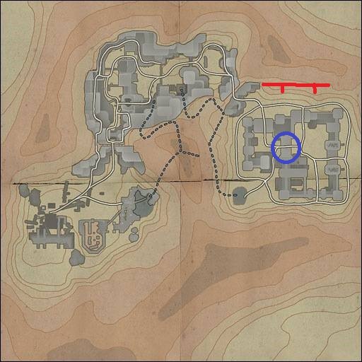

Another idea: How about axis' last spawnpoint is split between the current spawnpoint and the bed area above the inside arch shown below in blue. Also it could be possible to extend the main exit along the northern ledge like shown in red giving maybe 2 additional exits.
Also tried to show the changes in the command map.
The whole red box would be removed.
This will result in significant shorter distances for the attacking team. With unchanged spawntimes, this means that the attacking team receives a constant wave of new soldiers, because the time spent running to the battlefield is reduced in favour of time fighting on the battlefield.
Not changing the actual position of any spawns means that all original routes remain viable choices. Moving the attacker spawn forward, means that the player either has to run backwards to the tunnel or the spawnwave is split into two groups. Basically, you have to decide which attacking route you want to choose *before* you spawn. If you want to change your route after a very short respawn time where you haven't had the chance to change the spawnpoint, you will have to run the distance again. That is why I'm not a fan of moving spawns around too much. Plus, each additional spawn means additional entities, which is not improving performance.
If you look at proper competitive maps, then most of them have not more than 3 attack routes, because it makes it too hard to defend otherwise. It's not fun if you can't calculate the probability of when and where attackers pop up. Good defenders know when to start ticking the nade so it lands perfectly on the approaching enemy team. With too many routes (aka turning the map into swiss cheese) there is no way of saying where people will come from. In the command map you see marked in blue the original attack points. You notice that they are on one level. Once the attacker pushed past the blue line they are "in". I'm not a fan of routes that just put you into the back of the defender, when there originally clearly was an intended line of defense. It undermines all level design decisions.

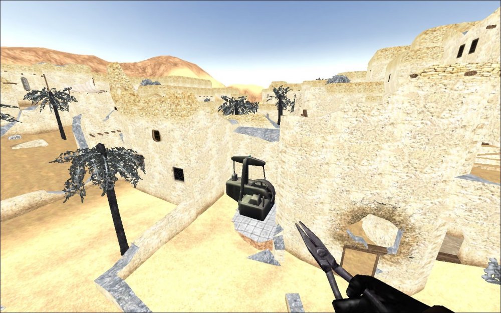

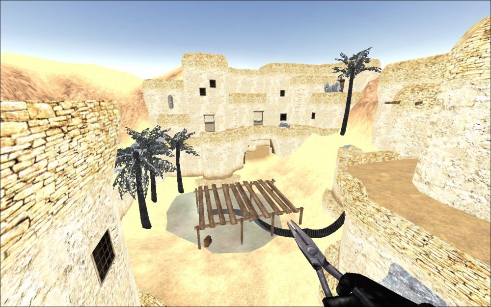

Not nearly done but giving a little update on what I've done. Feel free to give your opinions. Don't look at the bad textures/lightning, haven't worked on the visuals yet.
So just like in SW Oasis, the tunnel is more connected now. Therefore we only have 1 pump which is placed more in the middle of the first stage.
Added a forward spawn for allies when wall gets breached, u can still use the original spawnpoint to get to the tunnels easier. Also added another entrance to upper main(?)

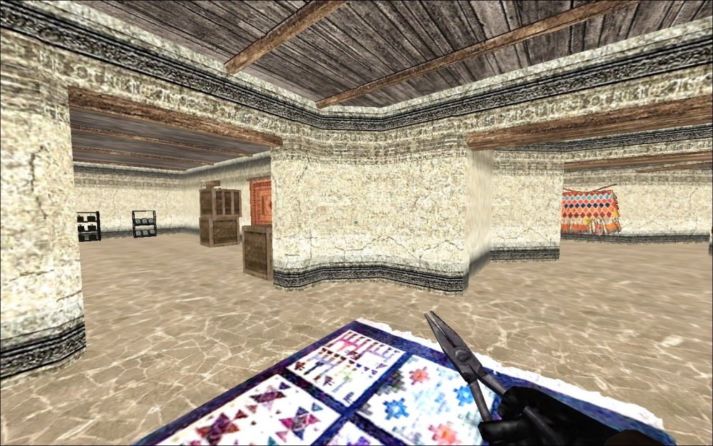

The inside has also changed a lot. Way more exits (total of 4) for the allies to push out now, and also added cabinets for health and ammo.

Turret area changed, allies can jump up from the other side now. (Will make it possible for single jump aswell)
