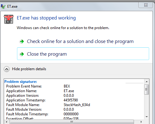

When i enter SW 2, the game just crashes with no crash report window.

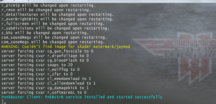

For some reason i can open console while the map is stuck at loading and this is what is showing up:

Sw 2 freezes as soon when the map starts loading and it crashes.

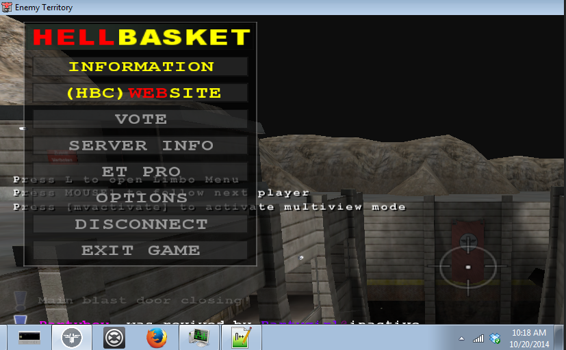

I tried this and it didn't work either, but for some reason I am now getting the crash window after doing this:
ok. I forgot to ask your OS... you use Windows?
Did you check etconsole.log? To enable logging make sure to have logfile "1" in your config.
Can you connect to other etpro servers?
I am gonna try connecting to another etpro server right now.
