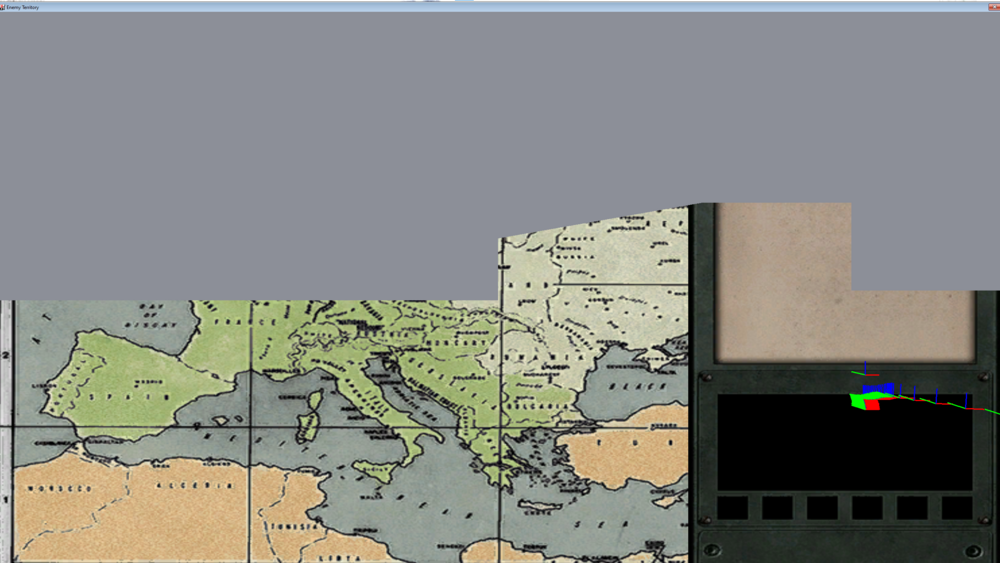

Hey there.
Once I load Jay-mod, screen goes black.

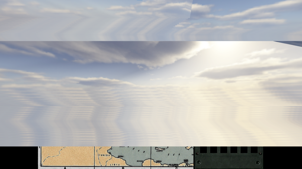

If I join another mod and then connecting jaymod, screen stuck on half loading screen and half on the sky.
anyone encountered such issue before?
Puni.
Wokring fine on all other mods.
Not legacy
@daredevil
Ever encountered such error?
I can hear everything, but picture froze

Problem is, it all started while reviewing demo.
I did /demo_seek_time and demo crushed, picture froze.
Ever since I can't load demos (jaymod) or joining a jaymod server.
Will update about full screen option
Edit: not helping. screen froze on this (I can hear everything and vsays and all). I'm also able to use consol without seeing it.image.thumb.png.7a0d73d117484bfc61d9a912e9eabc47.png
Edited by Puni
